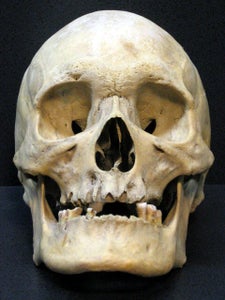

First you will want to do some searching.  You will need 1 photo of a person (animals work also), 1 photo of a skull or even a prosthetic mask and a texture to lay over all the images.  Depending on the angle of your person's photo it might take awhile to find a skull that matches it.
Step 2:
Open all images separately,  I usually use the face as my main background.  Apply the skull photo and resize to match the persons face.  After that with the skull layer selected either erase or use a vector mask to clean up the edges.  Use a soft brush so it blends in more with the photo of your face.
