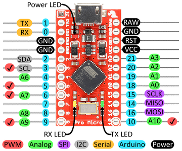

*NOTE* This will not work on all Arduino models (UNO, Nano, etc). You need a model that uses the ATmega32u4 processor which will work as a USB keyboard.

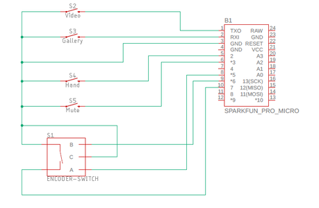

Step 2: Step2: Wire It Up
Now that it is all assembled, we can start attaching all the wires.
Start with the ground connections. Each switch has two contacts. One will be ground, the other will be the signal. Connect one contact from each switch together so they are daisy chained.
The rotary encoder has 5 contacts... 3 on one side, 2 on the other. Connect the middle one of the 3, and one on the side with 2. These two pins will be connected to the daisy chained push button pins. These will all go to Ground on the Arduino.
With the grounds out of the way, proceed to connect the remaining pins to the appropriate Arduino pin. Refer to the schematic for the correct pins on an Arduino micro.
Once it is wired, you can program and test the Arduino
