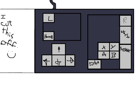

Step 8: The Buttons
you should now have a lovely square-ish controller... but something is missing!
you still need buttons!
you should still have the keys that you removed from the keyboard.
find the "a", "b", "x", "y", "l", "r", "~", "home", "up", "down", "left", "right", "+" (the tall one from the number pad), and "enter"(also from the number pad).
attach them to the controller as shown in the pictures.
