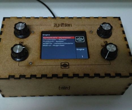

Step 17: First Boot
When you are sure that everything is in its place, it's time to boot the machine, so:
  1. Insert the SD-card with the zynthian image ready to run. If you don't have one yet, read this. You can insert the SD-card through the "window" on the bottom-side of the case. Also, if the case is still open, you can do it from the top.
  2. Plug the mini-usb power connector. A good 5V micro-usb charger is recommended (> 2 Amp).
These are the stages that you should see while booting:
  1. After 5-10 seconds, it will show the Zynthian splash screen
  2. After 3-4 seconds, it will go black
  3. If you are using a fresh zynthian image and it's the first boot, the stages 1 and 2 will be repeated
  4. After 5-10 seconds, the zynthian UI will be shown
If you get the Zynthian UI, congratulations!!! You are really close to get it!!
If you don't get an error screen or a blank screen, bad luck! Probably you made some mistake during the mounting process. You have to locate and solve the problem(s).
If you are using the Aruk RC-3 SD image (you should!), you will note that the controllers are not working at all. This SD image is pre-configured for working with the kit v2, so you need to configure the software for working with the kit v3. The simplest way of doing it is using the webconf tool:
  • Connect your zynthian to your local network using an ethernet cable (RJ-45).
  • From your web browser, access the zynthian's webconf tool by typing "zynthian.local" in the address bar. If this doesn't work for you, you should try with the IP. You can get the IP of your zynthian by navigating to the Admin Menu and clicking "Network Info". You should do that by using the "touch" interface: Click the top bar with a stick (or your nail, if it's not too wide) until you are in the Admin Menu. Once you are there, go down and click "Network Info".
  • Type the password (raspberry) for login into the webconf tool.
  • Once you are logged in, you have to access Hardware->Kit and select "Kit V3".
  • Save the changes and reboot your Zynthian.
