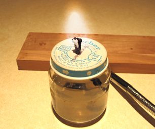

Step 3: Punch the Hole and Insert the Wick
Use the block of wood to back up the baby food container and punch a hole in the center. The hole size will depend on the thickness of the wick. You can use a drill to put the hole in, just make sure you clamp the lid down.
Use the tip of the shoe lace wick to pull it through the hole.
Cut off the tip of the shoe lace wick. Trim the wick length to a inch or so longer that the jar you are using to allow for wick burn off.

I flipped the lamp over to get the wick soaked, then placed it right side up on the table and lit it.
Be sure to keep an eye on how hot the metal lid gets you don't want the glass to crack. Use this only in well ventilated area and on a non flammable surface.
I have used these for hours at a time but you are responsible for your own safety.
