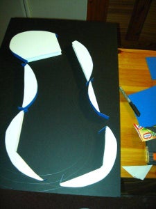

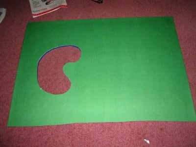

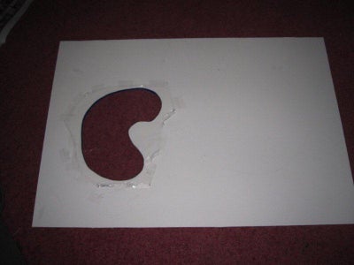

I started out by taping some sheets of paper together, laying them over the foam board and tracing out the shape that I wanted the conveyor belt to follow. I cut this out and it became the template for several layers in this build. Using the template I made a road from black poster board. This was glued to green poster board which was glued to foam board. The template was used to cut all this into two pieces, an inside and an outside and the gap between the two was widened to allow the pushers to come up through.

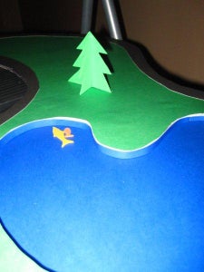

Trees are easy, just cut out two similar shapes, make a slot the thickness of the foam in the bottom of one halfway up and the other from the top halfway down. Slip the slots together and you have a tree. I used hot glue to secure them to the ground.

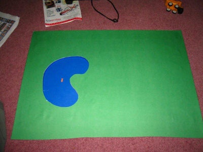

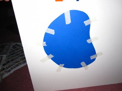

The lake was cut out of the ground, a strip of blue poster board was glued around the perimeter and a blue bottom was taped in place. A sheet of clear plastic wrap taped under the grass gave it a neat surface look and held the foam fish in place.

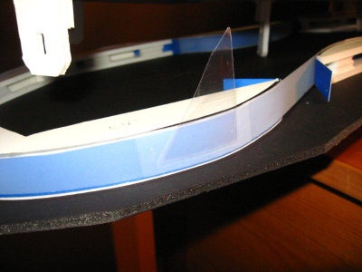

Using the road template, I created guides on the insides of the curves. I made them from stacked foam board glued together and put a strip of poster board along where the tape would run to provide a smooth surface. Then I glued them onto a piece of foam board. The tape was 3/4 of an inch wide so the guides were just a tiny bit higher than that. I laid out a length of tape sticky side up on a table. I taped down both ends so it was tight and very carefully laid down a second length on top, sticky sides together. The tape is easy to splice with more tape so if it is too short, make more to add. If its too long, cut it shorter and then run it around the track to get the exact size and splice it into a loop. I used some clear plastic from some recycled packaging to create the pushers. these stuck up enough to fit under the bottom of the trucks and catch against the bumpers. Doing this allowed the trucks to be picked up or placed down while the system is running. The plastic is hard to see and quite flexible so no one could hurt themselves on them.

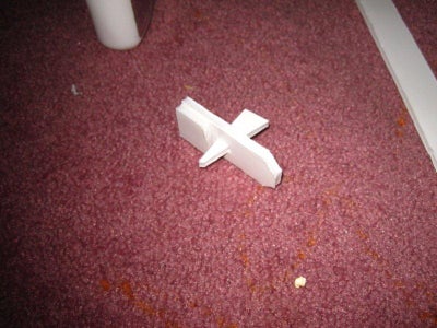

I made something similar to a mortise and pin woodworking joint. This allowed precise positioning of all the parts. Each one was glued to the bottom of the ground and pinned through the converyor system base. There was a slot for the pin to go through and the pin was a wedge shape to jam everything into place.
