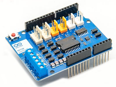

motors on the shield require more amps than an AA or a 9V battery can supply keep in mind that the shield can supply 4 amps to both channels (2 amps each) and a range from 6v to 12v DC. To know how much yours is visit:

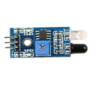

1. 2x IR line follow sensor (I used fc-51)
2. 1x arduino motor shield

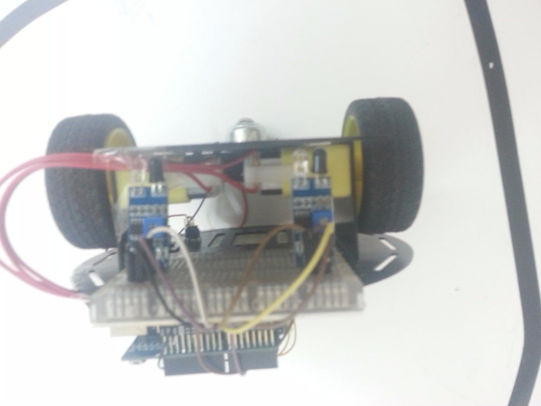

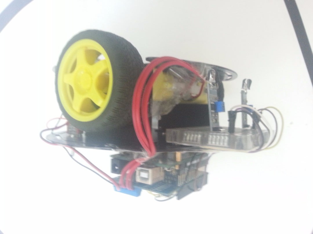

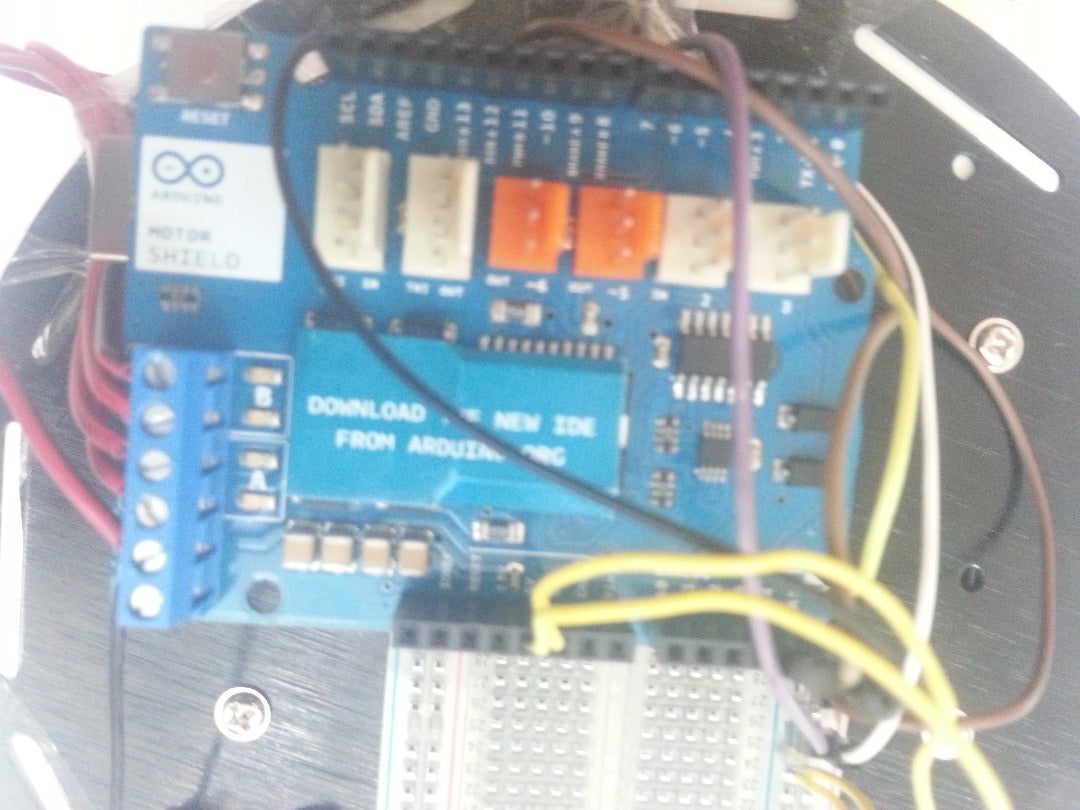

Step 2: Circuit and Connections
NOTE:
I couldn't find the fc-51 in fritzing so i put the humidity sensor there is no differences in the connection.
OUT of left sensor goes to A5
OUT of right sesnor goes to A4
POWER of both sensors go to 5V
GND of both sensors go to GND
