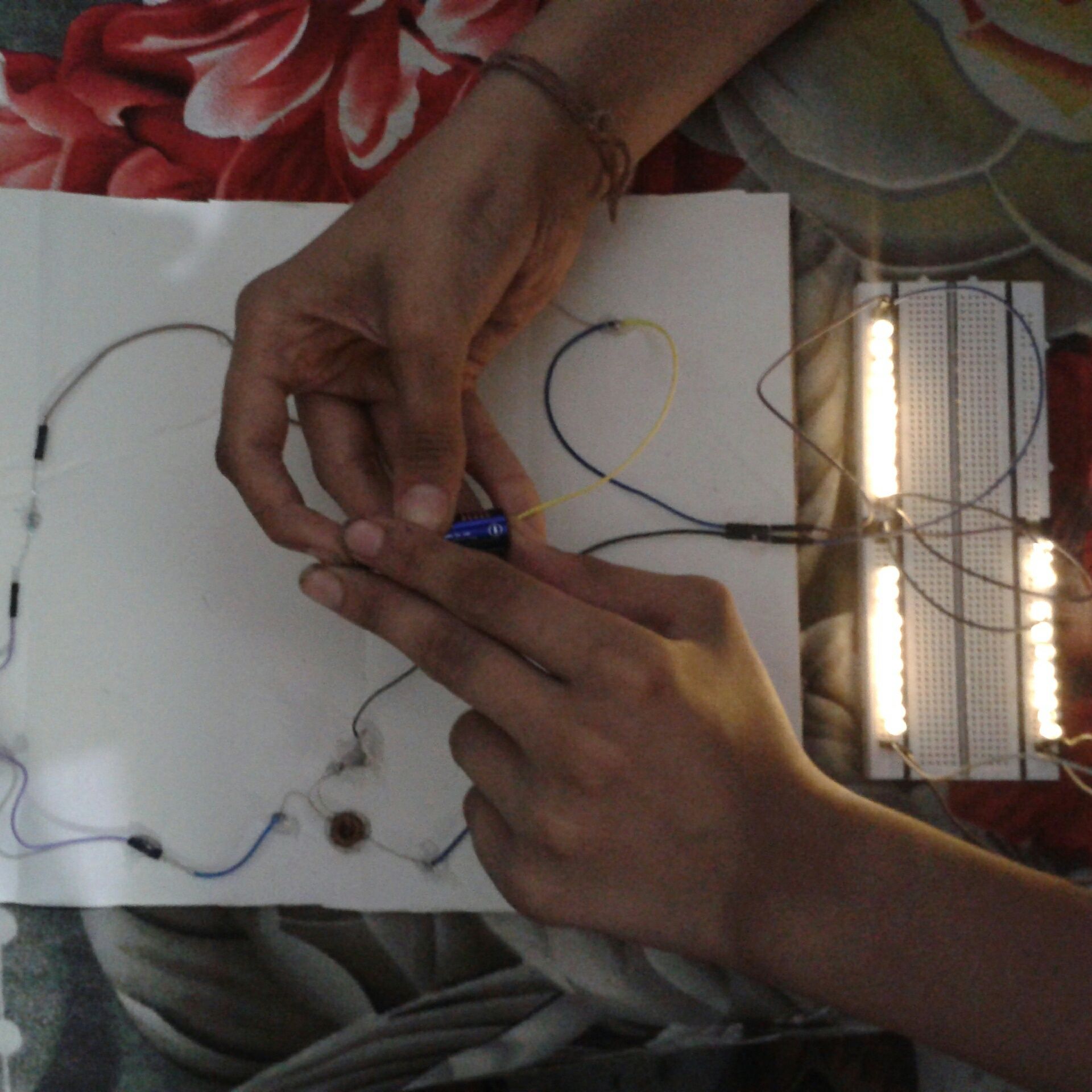

Step 7: Testing and Hot Glueing.
now take your 9v battery and then attach it to your battery cap and see it working. (IN THE IMAGE I HAVE KEPT MY FINGER ON THE
LDR TO BLOCK THE PATH OF LIGHT )
