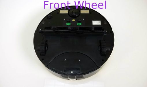

Step 3: Numbers 3 and 4
A number 3 means the front wheel is jammed. Clean the wheel with compressed air or use the cleaning tool to remove debris.

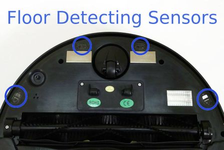

The number 4 means bOb’s ground detection sensors are dirty or blocked. (Highlighted Blue)
Wipe the sensors with a clean dry cloth and use compressed air to deep clean them.
If the issue persists while bOb works on carpet, try using bOb’s blindfold stickers. But remember, when Bob is blindfolded, he will be unable to detect ledges and could fall down stairs.
