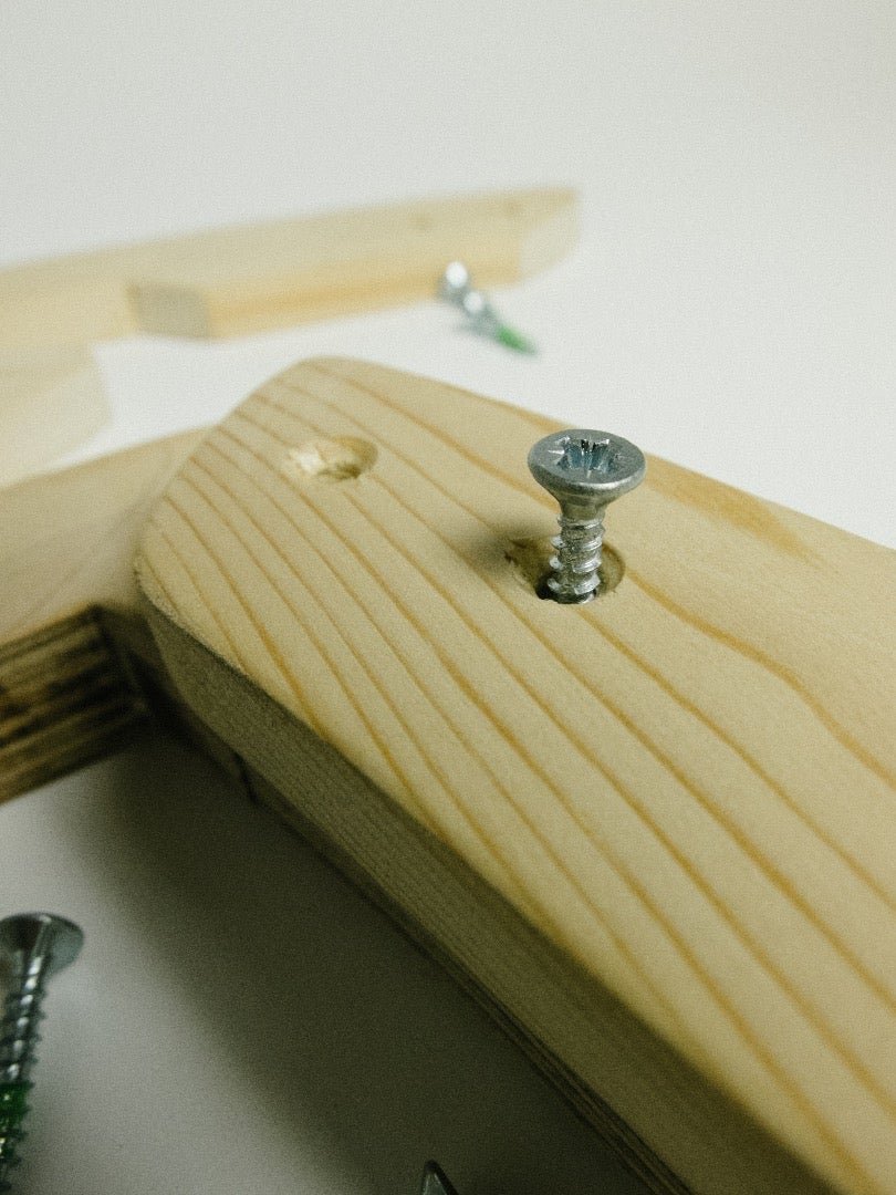

Step 9: The Cutting and Drilling
The general idea is 3 main parts and 2 other smaller parts.
Use the fretsaw to saw out these parts. First start with the middel part the long neck is for bridging the thick mattress. The segment where the rod is already in is where it contacts the bed frame. There need to be a hole there.
Secondly you saw the 2 other main parts that need to be symmetrical. The left segments of the part hook on the bottom side of the bed frame. You can shape them that way so there is a snugg fit.
The last parts are the smaller ones. These need to have a good length to be over the mattress. Another important thing here is the the incision for the fabric to slide into.
Step 10: Assembling the Holder
Assemble the parts using the screws with the wright spacings, you can pre drill holes and countersinks for a smoother part. When the holder is made you can sand the last piece of the other assembly down so it is a goot fit in the holder (see picture).
