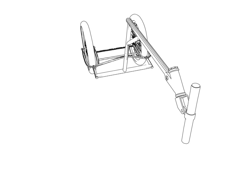

As you see the project is quite simple. The forks are horizontal and connected by two little pipes. All this acts as a surface plane, where we will link the toolbox. The main problem in a frame like this is to avoid big leverages on the weld joints, and I planned to stiffen the structure with diagonal pipes for both longitudinal and cross direction. In this way the weak part is the middle section of the vertical pipe, but it proved to be strong enough.

We used a kick scooter front part, which appeared to be so perfect for that purpose. Indeed the ring attached in place of the wheel will be coaxial to the seat tube, and both vertical and transverse rotation axis don't add any torsion on the seat post. The scooter steering wheel mechanism acts to freeing the last longitudinal axis rotation, although it's not in the exact horizontal direction. Indeed the three rotation axis need to be not aligned, but not exactly perpendicular one to each other. As you will see in the next animation this tilted axis will help to steer.
Step 4: Final Design
The 3D model came out pretty nice, and I was able to make a 3D animation, from which is clear how the trailer behaves during a turn. The bike and the seat post will tilt around the longitudinal axis, the trailer tries to follow it, but since the longitudinal axis rotation is linked to the vertical axis one, it's imposed to also move toward the inner side. That results practically in a much easy turn and better stability, at both high and low speed.
