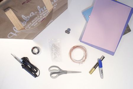

What you need to get started:
-Paper grocery bag
-Copper tape
-LEDs
-Coin cell battery
-Solder (not necessary! but helpful), solder wand (also known as an iron) may come in handy
-Craft materials (i.e. construction paper, markers)
-Scissors
-X-acto knife

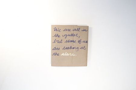

Step 1: Step 1: Construct Your No Tape Book Cover!
1. Cut the bottom of the bag off.
2. Cut down the entire length of the bag. You should end up with one big rectangle.
3. Lay the book on the paper and fold over the left edge of the book. Leave 2-3 inches from the binding.
4. Repeat step 3 for the right edge of the book.
5. Make horizontal folds along the top and bottom of the book to mark the height of the cover.
6. Place the book inside the cover.

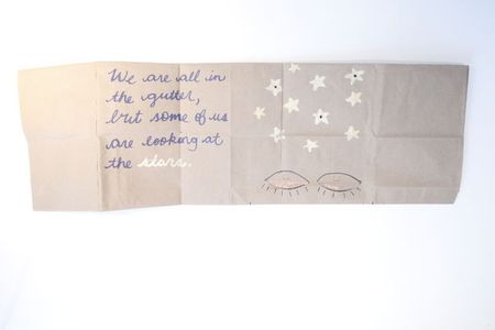

Step 2: Step 2: Pick Your Favorite Quote
1. Pick your favorite quote and write it on the backside of your book cover.
2. Sketch out ideas for the circuit and incorporate on and off switches.
*Switches are used to make and break the connection in a circuit which turns the LEDs on or off, respectively. In my sketch, I used the eyes as switches to close the circuit
Step 3: Step 3: Draw Your Doodle!
Draw your illustration using craft materials!
Here we used a gold paint pen, sharpie, and an X-acto knife to cut out the eyes.

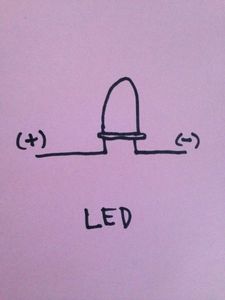

-For organization, split the LED legs apart and keep the positive legs pointing to the right and negative legs pointing to the left (see image). (Don't remember which leg and is positive and which is negative? No worries! The longer LED leg is your positive leg, and the shorter LED leg is your negative leg aka ground.)

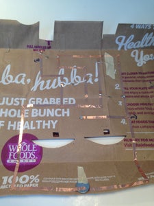

-Place copper tape at the appropriate location for your switch, so that your switch can "open" and "close" the circuit.
Step 5: Step 5: Create (+) and (-) Paths With Copper Tape & a Coin Cell Battery
-Add a coin cell battery to an appropriate location in your circuit.
-Create a single path from the negative side of the coin cell battery to all of the negative legs of each LEDs. (Remember, all of our negative legs are pointing to the right!) Leave a small space in the path to allow the switch to open and close the circuit (see image).
-Create another path from the positive side of the coin cell battery to all of the positive legs of each LED. (Remember, all of our positive legs are pointing to the left!) If you have more than one switch in your sketch, leave another small space in the path to allow the switch to open and close the circuit.

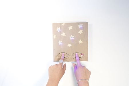

Step 7: Step 7: Cover the Book With Your Light Up, DIY Book Cover!
Place your book inside its new DIY cover, and show your friends. Happy blinking and building!
