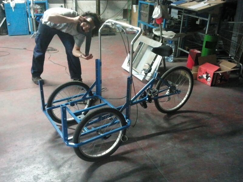

Step 1: Frame
bicycle parts and stainless steel straight pipe
Step 2: Pre-assembly

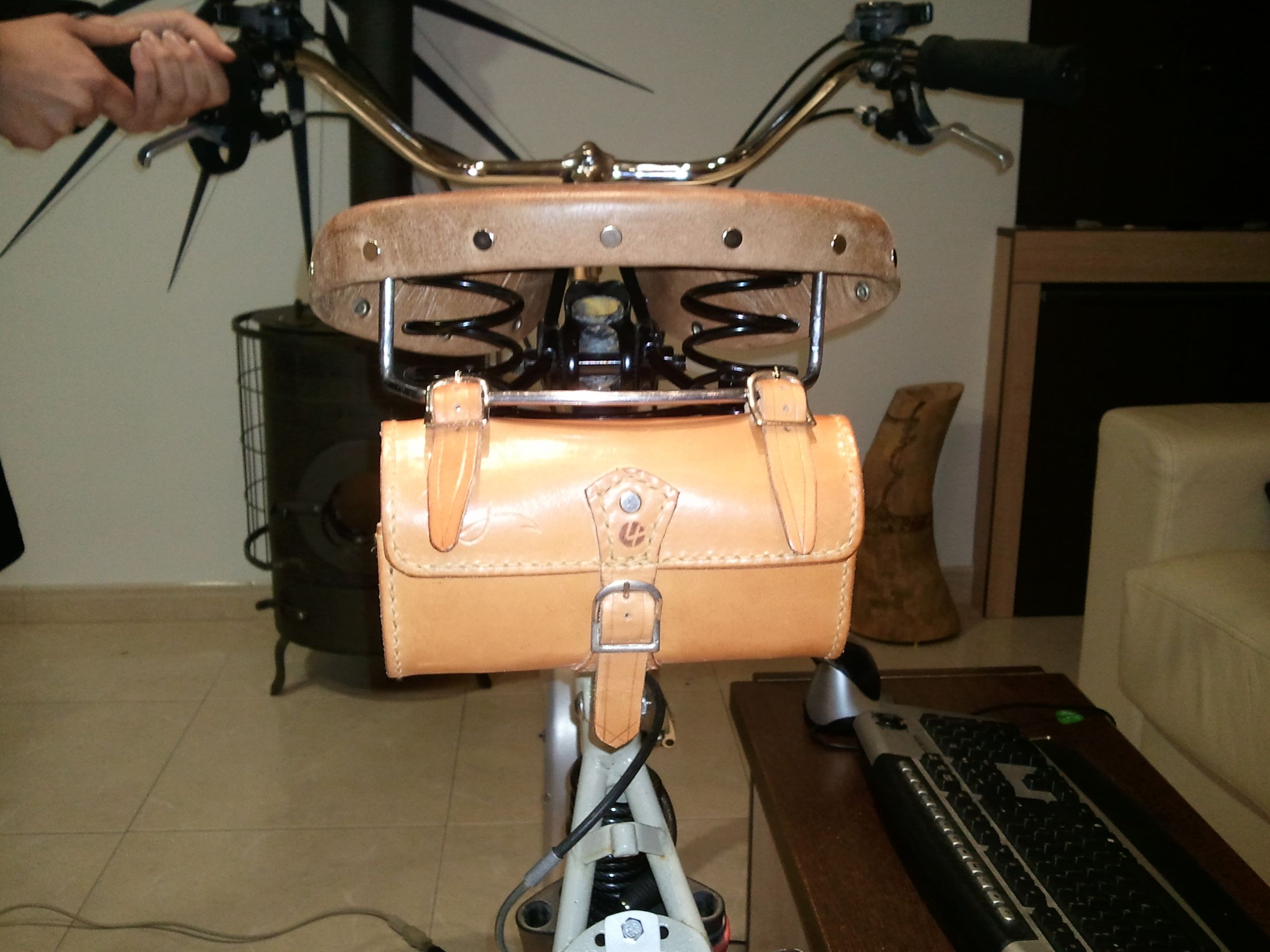

Purse for tools fact of wood and leather.Leather Bar Tape and saddle
lining leather
