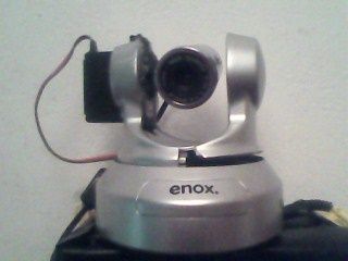

i am going to show you how to build cheap face recognition lock(buzzer) for door.
thing s you l need:
computer os win 7 (win 8 recommended)
arduino (i am using duemilanovo atmega328)
web camera(let windows install legacy drivers !!dont install drivers that came with camera!!)
key lemon (recommended 2.7 version because of less bugs)
arduino relay switch:
optocoupler
relay 5v
270 ohm resistor
diode 1n4007 or 1n4004
watch demonstration here

Step 1:
build relay switch for arduino( use external power supply to power relay)
Step 2:
now upload this code to the arduino :
