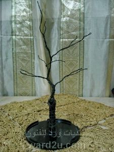

wire to make tree shape like
water colors
spray varnish
cut different lengths of wire and
wind them together
to make the tree shape
fix it on a base
i used cd case and wrap down
the wire around the middle
column

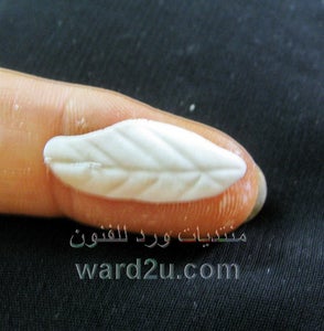

make small flowers
Step 5:
make small leaves

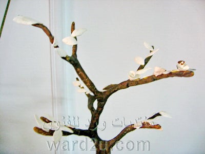

now we color the tree with brown color
Step 7:
stick  the flowers and the leaves on the branches
Step 8:
you will see cracks in the tree when the dough dry , do not worry
they make it looks natural

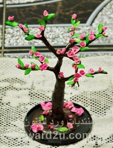

Step 9:
paint the flowers and the  branches
finally use the spray varnish to get
a shiny colors
