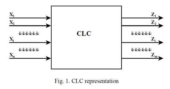

A combinational logic circuit (CLC) is an electronic circuit with n inputs,
noted by X1, X2, …, Xn, and m outputs, noted by Z1, Z2, …, Zm, for which the outputs
could be expressed according to inputs using a mathematical model such as:
Z1 = f1(X1, X2, …, Xn)
Z2 = f2(X1, X2, …, Xn)
ZI = fi(X1, X2, …, Xn)
Zm = fm(X1, X2, …, Xn)

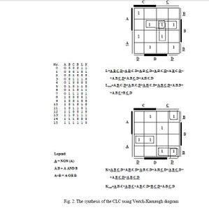

In the following we illustrate the problem of designing CLC by an example. In
figure 2 we show the process of minimisation with Veitch-Karnaugh diagram, and in
figure 3 is shown the resulting CLC.

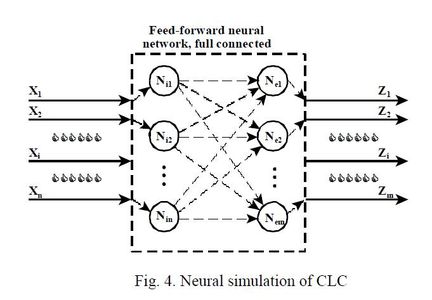

This paper proposes a special treatment of these CLC’s by means of the utilization
of neural networks. The solution was suggested by the functional similitude existing
between a CLC and a neural network with n inputs and m outputs. In fact, a neural
network of three layers was used, the first layer having n (4) input neurons and the
third m (2) output neurons (fig. 4). For the neural network the set of input and output
data is given by the truth table in figure 2.

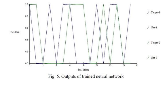

The simulations have shown that, for a network in configuration 4:6:2, the I/O
dependence of the CLC can be already achieved. If we note that for this network are
necessary 12 neurons (including the passive input neurons), it results an equivalent of
12 gates, in opposition with the CLC in figure 3 which uses 18 gates of several kinds.
It is obvious that, in hardware implementation, a neural approach for realizing CLC’s
functions can be competitive. In figure 5 one can see the real output of the “neural”
CLC and the desired output, for every combination of inputs in truth table
