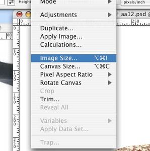

Step 3: Resize
After you have your image worked out, make sure you know what size it is. If its too small go to the menu bar to- image > image size. This will popup a box which will allow you to change the dimensions of your image. You can wait to do this right before output if you want, it’s a matter of preference, but don’t forget.
Now what you have is a photographic image that you want to convert into layers. Steps from here on will be based on your preference. Every method of conversion that I show you will give drastically different results. Sometimes it’s best to combine these methods.

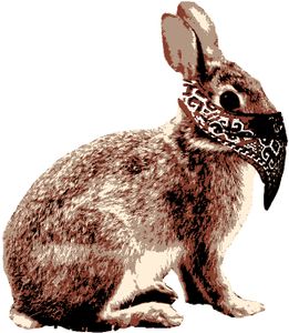

Step 5: Cutout Filter Details
In this menu you will be presented with three options
Number of levels
Edge simplicity
Edge fidelity
Number of levels is how the filter converts how many ‘layers’ the image will appear to have
Edge simplicity is how simple the shapes and lines will be
Edge fidelity is how true those shapes will be to the original image.
Adjust all these settings to find the image that you want. This means adjust the number of levels first to create the number of color layers. After this you can use the other two sliders to increase or decrease the details. in this preview window you also have the option to zoom in and out on your image while previewing what all the adjustments are doing. I would suggest making a change to the settings, zooming in to see the detail and complexity, then zooming out to see if the image is still convincing.
This filter will sometimes create strange color areas. for example, you may be creating a stencil of an person and the filter makes one eye black, as it should be, but it interprets the other to be gray. There are two ways of dealing with this. The first is to just let it go and remember what it should be. The other is to step the detail, and levels up and down to eliminate these problems. Another option is to apply the filter to areas of the image separately to get the necessary results in specific locations.
When you have made all your adjustments you will hit ‘ok’ and Photoshop will convert your image. Keep in mind this is, for me at least, only part of the conversion process options.

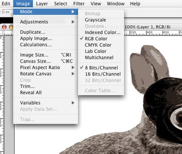

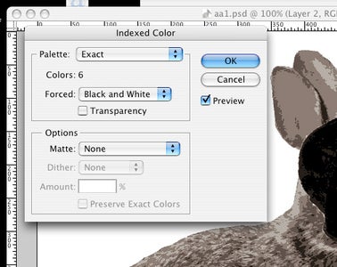

Step 6: Index Color
The next option (which again can be used alone or in combination with other methods) is changing your image to index color. This is a fast simple way to convert your image to limited color sections.
In Photoshop go to (Image > Mode > Indexed Color). You will be confronted with a popup window with multiple options. The first is ‘Palette’, for simplicity’s sake, ill have you pick ‘local (selective)’ from the dropdown menu. After you figure this method out, feel free to try the others (especially custom). Next choose the number of colors that you want, this is equal to the number of color layers that you want. Under that you can choose to force colors, I tend to force black and white simply because I prefer to stencil with those colors anyway. Make sure the preview box is checked and the ‘Transparency’ box is not. Also, make sure that the dither option dropdown menu is set to ‘none’. At this point I tend to go back and change the number of colors so that I can see how the image looks.
Once you change an image to indexed color, Photoshop will not allow you to apply filters, but you can apply the indexed color mode then go back to Image > Mode > RGB color, and it will then allow you to make filter modifications.
If you think you may combine any of these methods, make sure that you have the same number or more layers, levels, or colors than you will want in your final stencil. You can always reduce detail, but you cannot get it back.
The indexed color along with the cutout can make a very precise and detailed image. It may not be as fast or easy as one filter by its self, but I find more clarity and better imagery when I combine a number of things, and even use them multiple times.
Take note that every process and filter is specific to the image, there is no equation for getting a good stencil layout every time.

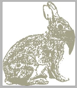

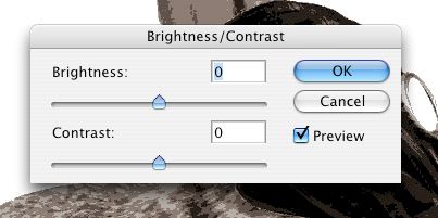

Step 7: Brightness and Contrast
The next option is using simple brightness and contrast. TuTu does a great job of explaining this one. Basically in Photoshop, or a comparable program you can adjust the brightness and contrast to where you get a simple black and white image. Hit the contrast up to max, and play with the brightness slider. These are under image> adjustments> brightness/contrast. You can make multiple layers with this method, just make sure that they are different enough from one another.
If needed, make a new image, copy and paste the layers into the new image one by one, and use the magic wand to select then fill them with different colors. You can then overlay and organize the layers to get a preview of what your stencil will look like and what colors go well together.
