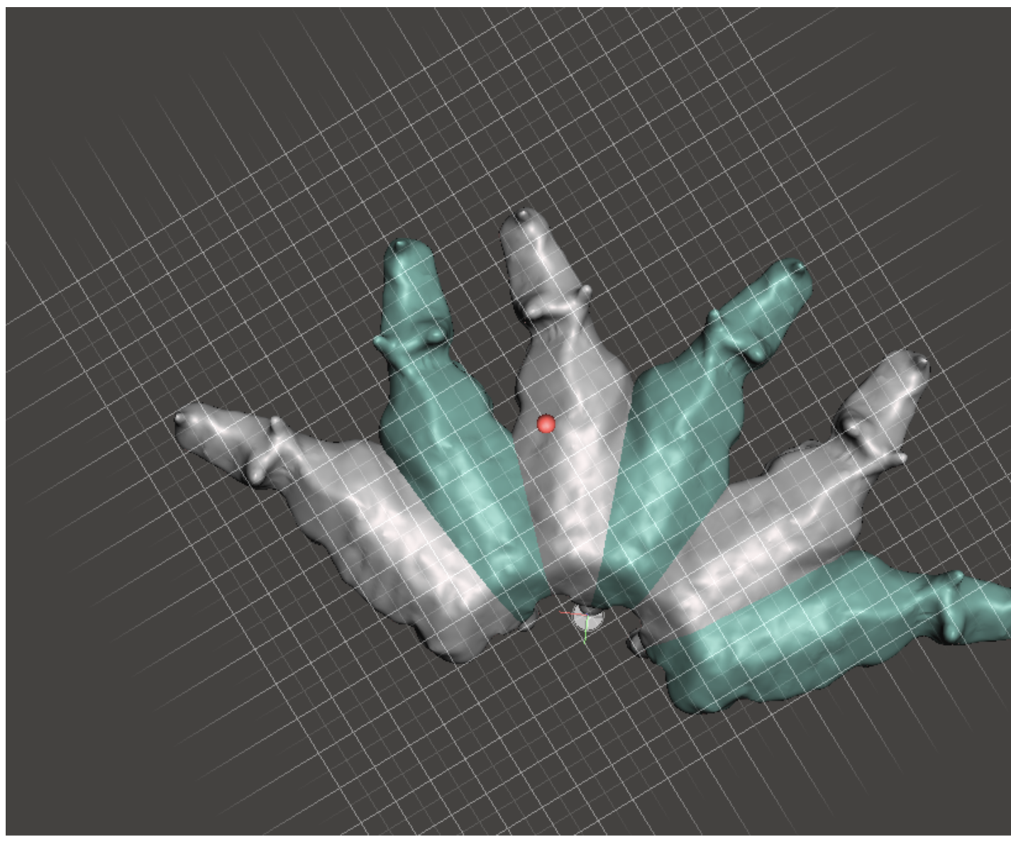

Slicing this in Cura revealed another issue. Because of the Cap component (or of course the way I was using it), the hole for the stems did not persist and was filled in. Also another issue presented itself -- I was using a new model with the pinch height above the opening (see image). This created an overhang structure that was unsupported in the print (you can check out the images of the slicing to see this for yourself). So I tried to generate a support structure but the support looked very dense to the point of not being able to remove the object itself.
Going back into Rhino and Grasshopper I removed the cap component so that the hole would persist and modified the design with the pinch below the opening so that it might rest on itself. The final result (model and slicing) is also shown. This is not a single geometric object but I think it will still print.

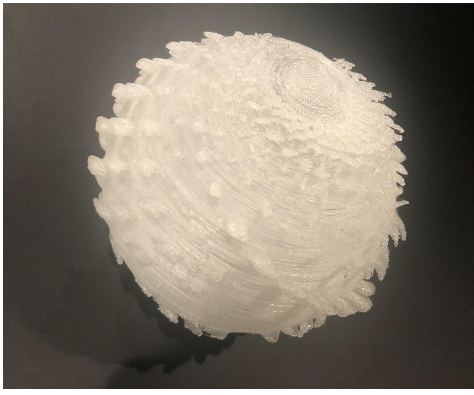

Then in fabrication I realized I had not been mindful of the resolution of the printer! The first object had a shell that was too thin. The result was a nerve-wracking print wondering if the neck would snap in on itself (the lower part of the neck was so thin that there wasn’t a solid shell filled in).
It printed! I’m impressed with how well the geometry was handled since it is quite an organic shape. I like objects that reveal the process that was used to make them and to some extent that is clear in the imperfects and visible shell outline that shows the direction of the print. I think the picture with the glass object, 3d printed vase insert, and flowers is a cool spatial composition that shows a compelling contrast of materials, processes and durability.
I’m reprinting after adjusting my parameters. I’m making a slightly different shape with thicker walls for a larger glass. I adjusted the design so that the base hopefully will be better incorporated into the neck. I also changed out my filament to use a lighter color so hopefully the undulating surface will be more visible in the photos.
There are still issues with the prints. The overhang extrudes in air… maybe I can use a support structure or make sure the curvature is not too aggressive. Or I can create my own gcode that specifies the paths so the print better adheres to itself... maybe something to try this weekend! In any case, I’m happy with the outcomes!
