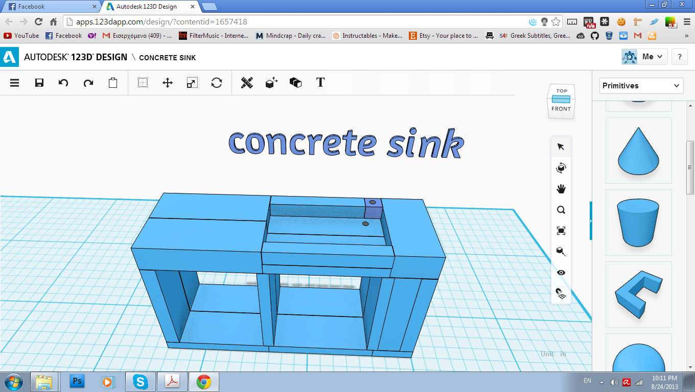

This is my latest work, bathroom makeover. It is a wide sink (60cm x 40cm) with lots of space underneath.
The total cost is under 70 euros

Step 2: Ytong and Glue
I started the construction with ytong blocks. In order for them to stand and tick together i used ytong adhesive. The blocks i used are 60x25x5 at the base and some for the vetical panels, 60x25x7.5 at each side and 60x25x15 on the top. https://www.instructables.com/id/concrete-sink-123D/
