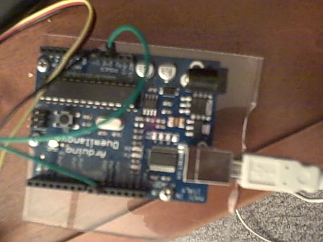

after about a month of have my arduino I got bored so I was surfing the web and found this cool way of controlling arduino
if you do any thing illegal i am not held responsable
Step 1: Things Needed
1.arduino (duh)
2. computer (if u are reading this you have one unless it is not yours _)
3.usb ports(most computers have these)
4.time(took me 5 hours to figure it out & to cofigure to my servo)
5.servo
6.JOYSTIK

9 years ago on Step 2
how do u upload the programs to the arduino if your using python?
Reply 8 years ago on Introduction
the arduino ide. python just sends commands over serial com
