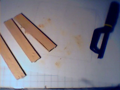

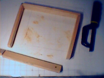

Step 2: Cut
now cut the wood bar in order to create a square of the same size of the mirror but don't glue it,
also drill a hole for the power supply, as you can see in the picture.

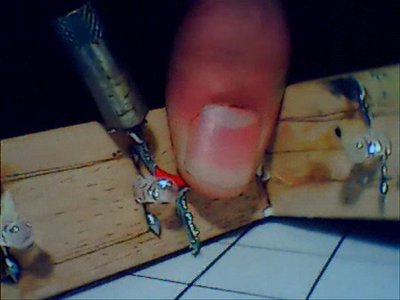

Step 3: Led Strip
now build a led strip on the inner side of the square as shown in the picture(be sure to add also resistors as shown below)
than glue all together

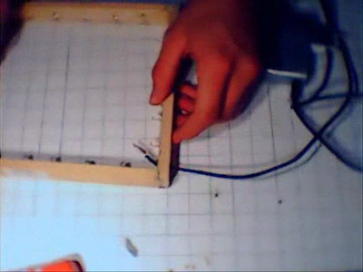

Step 4: Connect the DC Transformer
attach the positive and the negative wires of the dc transformer to the positive and the negative side of the led strip

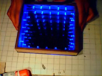

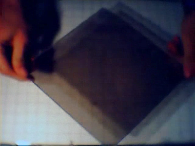

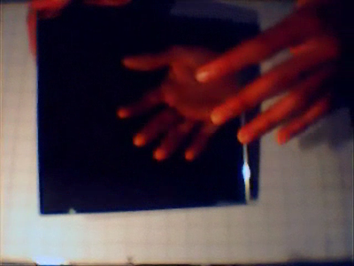

Step 5: Attach the Mirrors
finally attach the regular mirror facing the inner side of the frame and the semi-reflective mirror on the other side,and you will see an amazing led tunnel!!!
