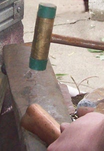

Find a nice hard surface to hammer the copper on, this will be the anvil.  In a pinch you could use the sidewalk, but it WILL pattern the copper with the small irregularities on the pavement.

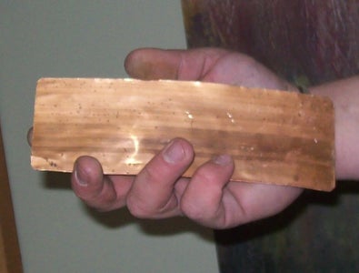

If the end cut has been spread open wide with the pliers, the tube will flatten easily.  Just keep moving up the length of the tube as the part that you are hammering flattens out.  Be sure to turn over the sheet as it flattens to get the edges as flat as possible.
Step 4: Trim Sheet Edges to Shape
The edges of your plate will be a bit jagged and sharp.  Draw parallel lines on the plate as close to the long edges as possible.  Use snips to cut the edges along the lines drawn to something far more smooth and less likely to shred you.  Be sure to clip off the corner so that you will be able to make a smooth curve later.

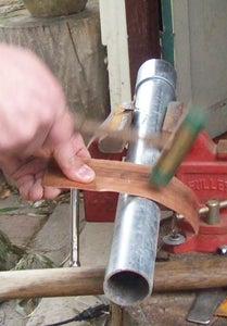

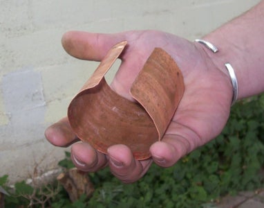

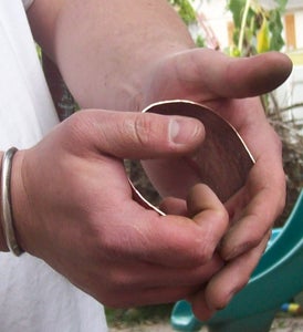

Get a large diameter piece of steel or iron tube for your mandrel.  Using the soft faced hammer, start to bend the very edge of the bracelet.  Use sharp overlapping strikes along the width of the copper to start the copper curving.  It will look much smoother when you are completed.  Once the copper has a bit of curve, take the metal in hand and manually put a sharper curve in the metal simply by carefully bending it.  This is a great deal quicker and much easier.  From there put the curved copper (now very MUCH like a cuff) on the mandrel and hammer smooth and symmetrical any parts of the bracelet that look out of place until it all looks right.  Or at least, right enough to you.
Step 6: FINISHED!
The bracelet needs some filing with a very fine file to clean up any weird spots or rough bits.  This is also the time to file round the corners to make a smooth corner at the cuff opening.  I like to keep the patina that the copper has picked up during it's life as a tube.  No two pieces of tube will have an identical pattern on the inside.  The older the tube, the more verdegris it will have on the inside.
