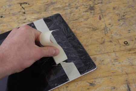

Step 5: Cover You Tablet With Clingfilm
Before working on your hooks, wrap your tablet in cling film (cellophane wrap in the USA) this prevents sugru from bonding to your tablet
I like to use masking tape to keep the cling film from moving around during this project.

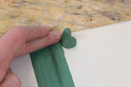

Step 6: Create the Rubber Grips - PART 1 Sugru Dots
Left or right handed - which side of the book do you want to mount your tablet?
To create the hooks it is best to do it in two parts. First create a sugru base at the points where you want your hooks to sit. Then create the hooks in this position. Sugru bonds really well to sugru so by building the hooks this way you can concentrate more on the build and design of the hooks and less on the bond.
You will need around 2 mini packs in total - roughly half for each corner
Make a small mark on each corner of the book where you want your tablet to be located.
Press small sausages of sugru onto the points that you have marked. Ensure that there is a strong bond.
Step 7: Create the Rubber Grips - PART 2 Creating the Hooks
To make the hooks make 4 even sausages of sugru from the remaining sugru.
For each corner, press the bottom of each sausage into the dot that you have already made in the corners of the cover.
