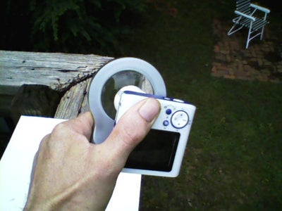

Only photo on this not from my Izone camera
this is a 3x magnifying ,from test I am getting nice photos with the camera on 4x digital zoom.
The coupler holds the lens 1" from the camera it slips off leaving the little 9/16" bushing attached.
Photos taken with the coupler on camera did not infringe on the frame.
