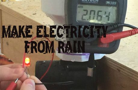

This is a downspout generator to convert all that energy being wasted.
this should generate about 1 watt in a continuous rain

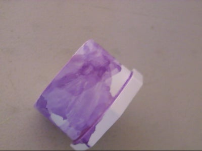

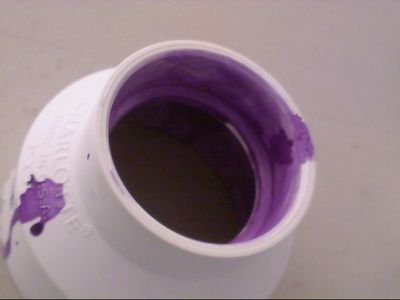

Step 2: Purple Primer!
purple primer helps the joints (the parts of the PVC pipe touching each other) set correctly
wear your gloves while you do the next two steps
prime these places with your purple primer
  • the outside of the bushing
  • the whole inside of the reducer
  • and one of the outside ends of the pipe

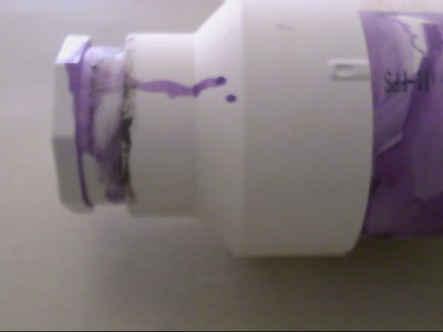

Step 3: Cement It!
Get your PVC cement and start cementing the places we primed!
be careful PVC cement dries super fast so get them together fast
  • cement the bushing to the reducer
  • and the reducer to the pipe

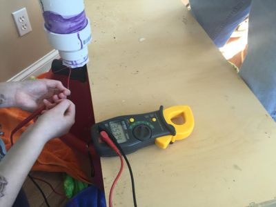

Step 6: Voltage Tested
I tested it indoors (it wasn't raining) and with water six to seven feet up the PVC pipe I got 4 volts
more water in the pipe = more electricity
