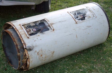

Step 1: First Off Find an Old 40 Gal Hot Water Tank

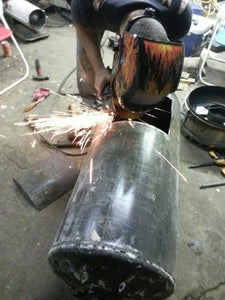

using a grinder or tin snips cut the outer shell off and scrape off the expanded foam from the inner tank

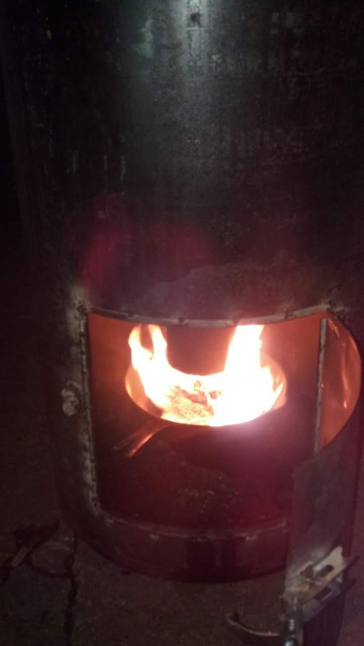

Step 2: Cut Out a Door

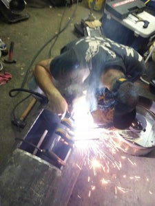

once the door is cut out you need a backstop so when you close the door it stops flush with the tank. scrap pieces of steel welded on the inside of the doorway does the trick

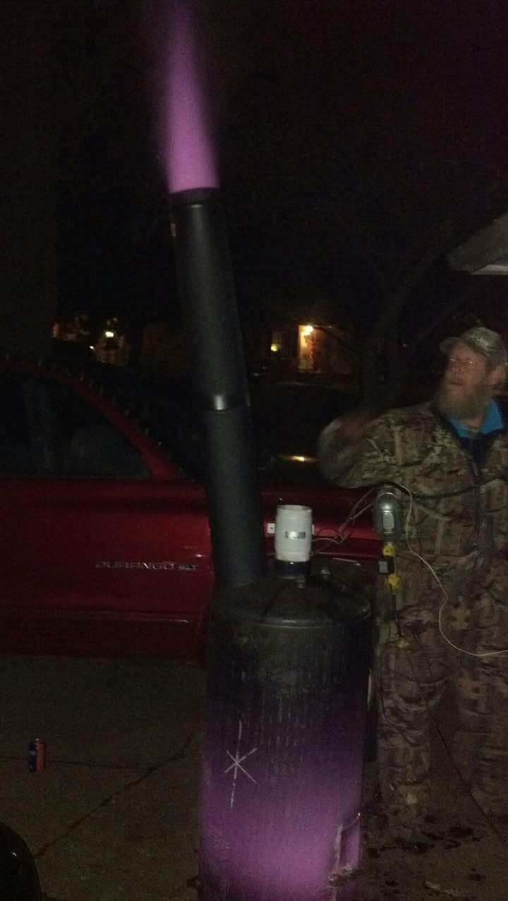

Step 6: Bring It Outside and Give It a Test Burn So Any Leftover Foam Is Burnt Off and Don't Stink Up Your Shop

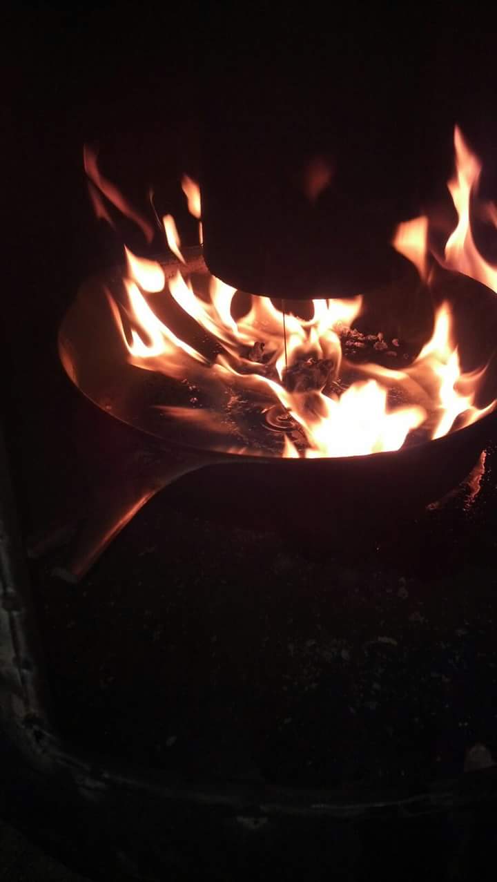

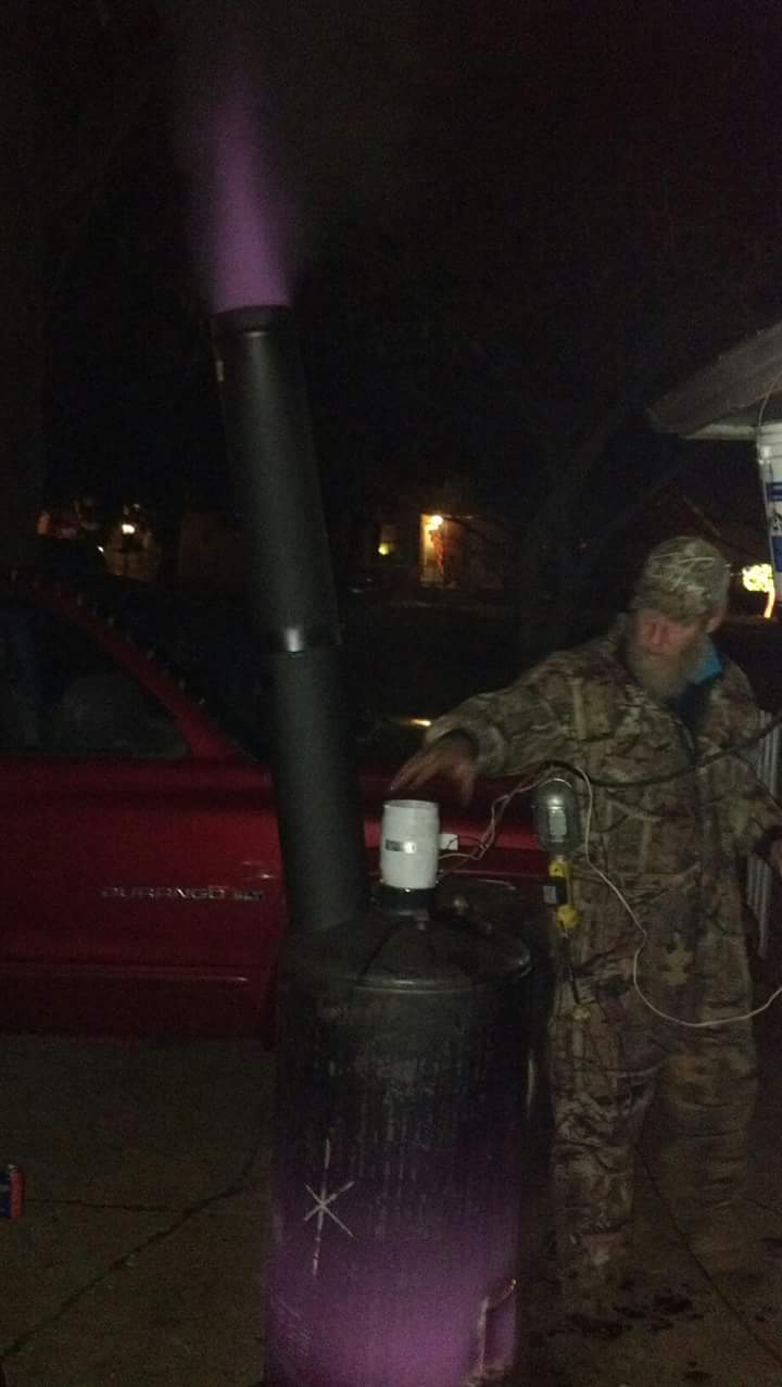

for the burn plate i just used a cast iron skillet that catches the oil and once hot it vaporizes the oil then instantly burns it. for the initial burn I ran it with the oil at full flow to see what it was capable of, even with a 3 inch air inlet it at full flow of oil it needed more air to burn clean so I used an old engine bay exhaust fan from a boat. (the white thing my dad is holding). as you can see I got it hot. the majority of the heater was red hot and I had about a 2 foot flame out of the chimney. now in no way do I ever need to do that again. I wanted to see its potential and it more than satisfied my curiosity..
