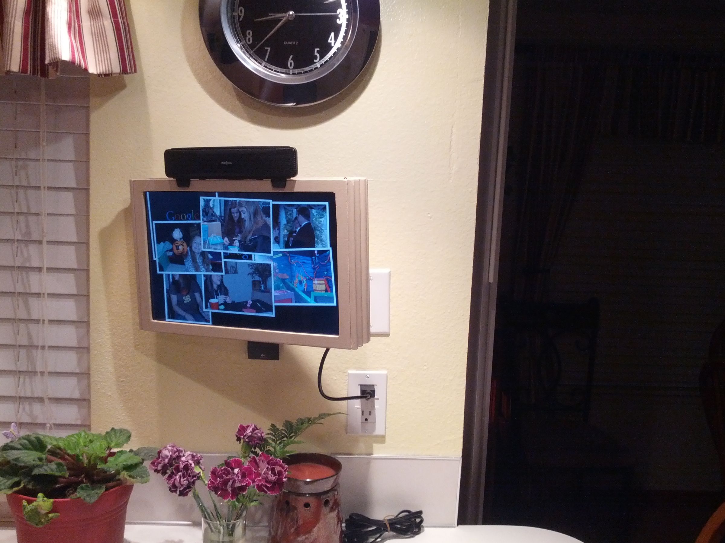

Stand offs used for mounting a motherboard in a desktop pc & the two screens are in place. Now I can secure the motherboard and other hardware. A vga cable connects to the other screen as a secondary monitor for the laptop. I used a 2.5" hard drive enclosure to hide the extra cables in. The power bricks, screens & hard drive are held in place using desktop rear PCI expansion slot cover plates which I shaped and cut to fit. There are two magnets from inside an old hard drive which holds it in the closed position.
Step 4: Final Step
Mounted on the wall with a pair of usb powered speakers pointing up through the top opening. It's set to start Windows without any user input required and Google screen saver starts pulling images from my server for 2 different pics every 10 seconds. There's also a wireless mouse nearby for making changes or looking up info on the internet, playing music...etc. I also have it set up to power off the screens between midnight and 7am. I use speedfan to email me alerts if the cpu gets too hot, no problems so far (it's been on nonstop for several weeks)
I still need to feed power up through the wall so I don't have those unsightly power cords hanging down.
