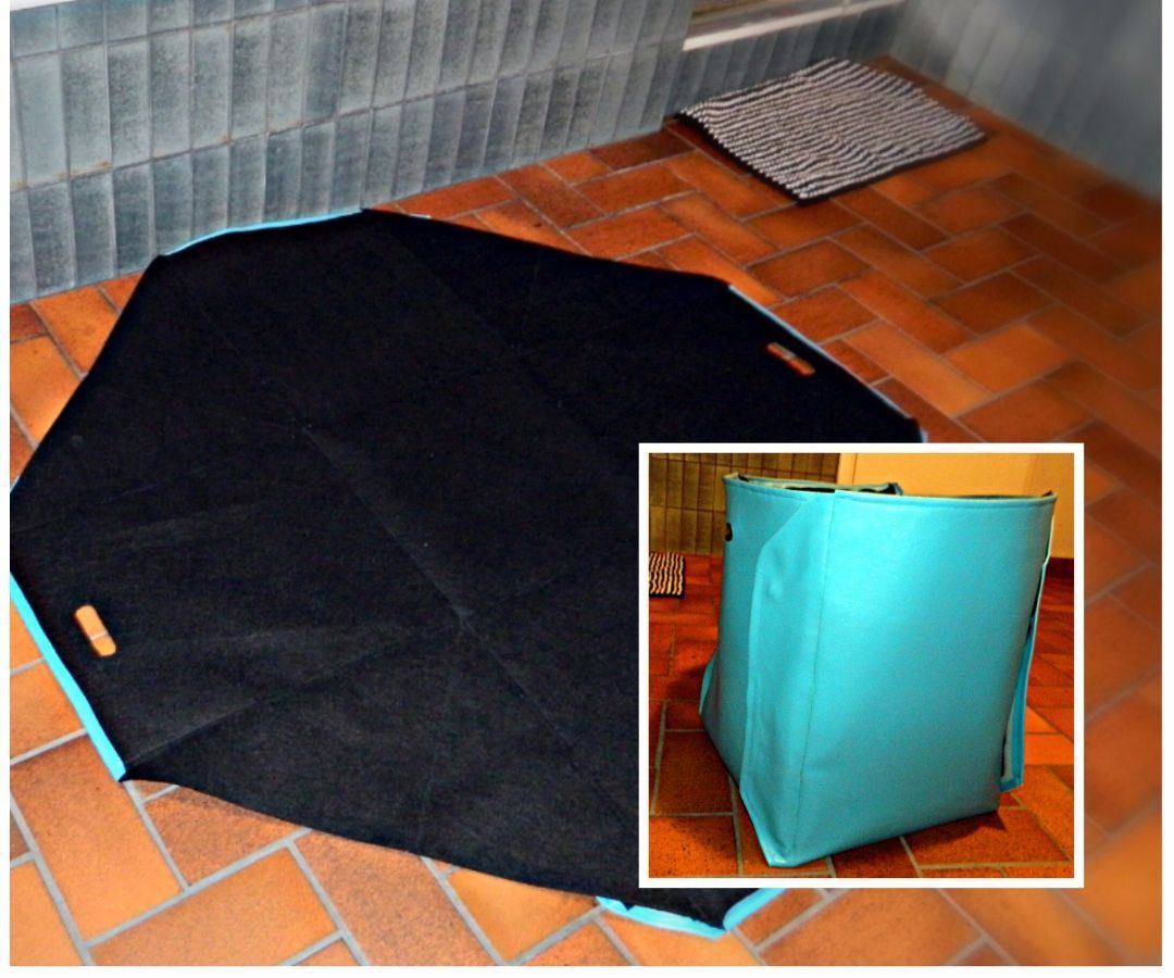

Step 3: Coating
the steps are shown in red on the drawings
- take the to slides strong cloth and put them on each other
- draw the pattern on the cloth and cut it to size (stand in cm)
- sew three sides of the cloth on 1.5cm
- then turn the cloth inside out
- sew the last side to 1.5 cm and cut it off nicely
- give an angled cut in the corner
-draw the inside pattern
- fold the cloth inwards and sew them around
- cut in the middle of the side a gap of 5 cm, and also the other part of the inside cartridge is (be warned: Stay 1,5cm from the side)
- sew the inside patron
- grab the extra piece of cloth
- sew the two sides
Now it is ready
