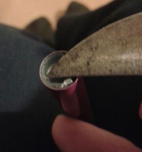

On the first one I just grasped the top bezel with a pair of pliers and twisted the bezel broke and I pulled the contents out of the top with a pair of tweezers. On the second I placed the tip of a pen knife (a Stanley knife or craft knife would probably work as well) into the mouth piece hole and pushed down hard on a firm surface then rotated the tube 180° and did it again I was then able to prise the mouth pice out with the tip of the knife (it should be noted I'm not at home to mr health and safety that knife is sharp and had it slipped it would have been messy) you might want to use something blunter to leaver it out.

Tap the open end an old news paper on the table to shake the contents down then prise and pull them out the design of this second e shishee is slightly different it has a plastic tank for the vapour liquid which might actually make it refillable especially as the whole of the electronics came out intact
