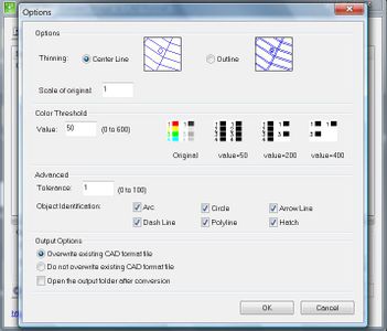

load up Img2CAD
make sure your options are set where you need them, i use a threshold of 50 and tolerance of 1.
pick the save directory, load the .png file and click on convert.
