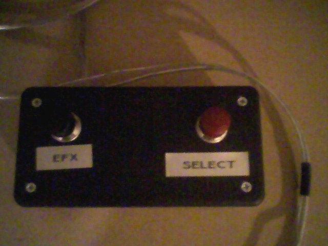

With out rocker switch(pic one)
1 Drill 2 holes (one on either side)for the jacks.
2 Drill one hole in the center of the cover for the momentary
switch
With rocker switch(pic two)
switch
3 drill one hole in the front for the rocker switch.
Step 3: Wiring and Sodering
With out the rocker switch.(pic one)
1 Install the switch in its hole, tighten the nut on the momentary switch.
2 Solder a wire connecting the two short posts on the jacks
together
3 solder a wire go from the long jack post to the other long jack post
4 solder wire go from the amp side jack(left)long post to the momentary switch and a wire go from the momentary switch to the shoter post on the amp side jack.
5 insert the two jacks in there holes and tighten the nut on(make sure the long post is not touching the bottem of the box because when you plug in you will bend the jack.)
With Rocker switch(pic two and three)
1 Install the swiches in their holes, tighten the nut on the momentary switch and glue in the rocker switch if you can't get the nut on.
together
5 solder wire go from the amp side jack(left)long post to the rocker switch and a wire go from the rocker switch to the shoter post on the amp side jack.
6 insert the two jacks in there holes and tighten the nut on(make sure the long post is not touching the bottem of the box because when you plug in you will bend the jack.)
