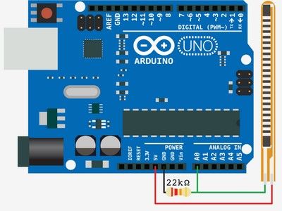

- Solder the connecting wires to the flex sensor.
- Use a double sided tape to fix the connector end of the flex sensor inside one of the lead casing while being careful fixing the connector end.
- Connect fingflex to arduino.
Follow the schematic given in the next step.
Step 2: Connections
- Upload the Analog Read sketch from the IDE. Make sure you have attached the flex sensor to appropriate analog pin mentioned in the sketch.
- Start the Serial Monitor from the IDE. As you bend the finger, you will see that the values linearly respond accordingly.
- You can use these values in your own program to determine the extend of bend movement. Similarly implementing simple math you can derive data in percentage ranging from 0 to 100 after recording minimum and maximum flex sensor values for the amount of bend on sensor you require.
