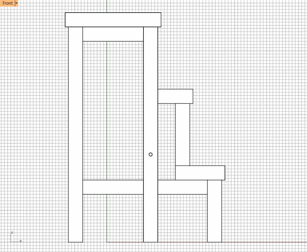

Step 4: 1st Version Dimensions
here you can find all the dimensions necessary to build the stair. When you design the connections between beams, boards and wood legs consider them to determine the elements length. For instance if you want to use wood pins, you already have right dimension in my schematics, but if you want to make joints, you have to add the joints length to the element length.
A note about the dimensions, all the wood boards are 4.5 cm thick, and all the beams have 3.5 x 4.5 cm section, disposed with longer inertia in direction of the shorter side of the bench, so to save more space for the inner steps.

Step 8: 2nd Version Dimensions
Here you can extract any information you need to build this version of the stair-bench.
I repeat the note since you could think some measures are missing: all the wood boards are 4.5 cm thick, and all the beams have 3.5 x 4.5 cm section, disposed with longer inertia in direction of the shorter side of the bench, so to save more space for the inner steps.

Step 11: 3rd Version Schematics
And here the schematics for this bigger version. Again all the wood boards are 4.5 cm thick, and all the beams have 3.5 x 4.5 cm section.
