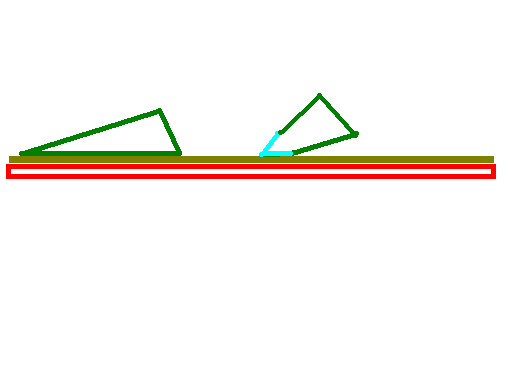

place the blade flat against the sandpaper, see the crude paint shop pic. The blade on the left is a single angle and the right one is a 2 angle knife, the light blue section is the cutting angle.
Hold the blade flat against the sandpaper. Note that the red is the glass and the brown is the sandpaper.
If there are 2 angles on the knife try to match the cutting angle (this takes practice but you will get the hang of it)
