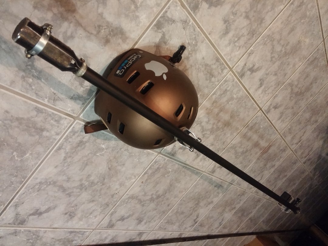

after cut the tube you will cut to have 4 parts like the picture
than put the piece of solid iron or any heavy thing
bend to fit and put the hose clamps, and the other one will stay where the cut finish, where i have my hand in the 3rd picture

in this part you will need to put the gopro in the side and the iron in the other
put in you finger and try to find the balance point, this way that i find the place to put the castor.

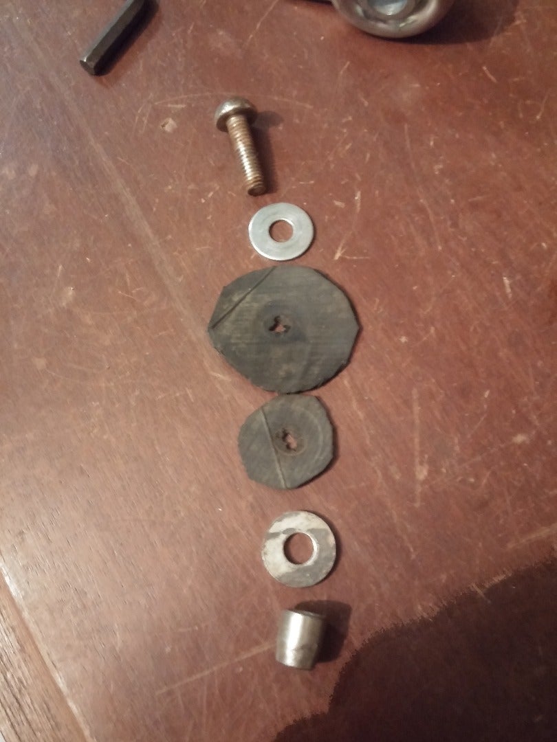

now you will need to do a hole in your helmet to put the castor
i changed the castor screw to an smaller and thinner one, the bycicle v brake one and with the washers and piece of tire
now you just need to paint if you want, and use
