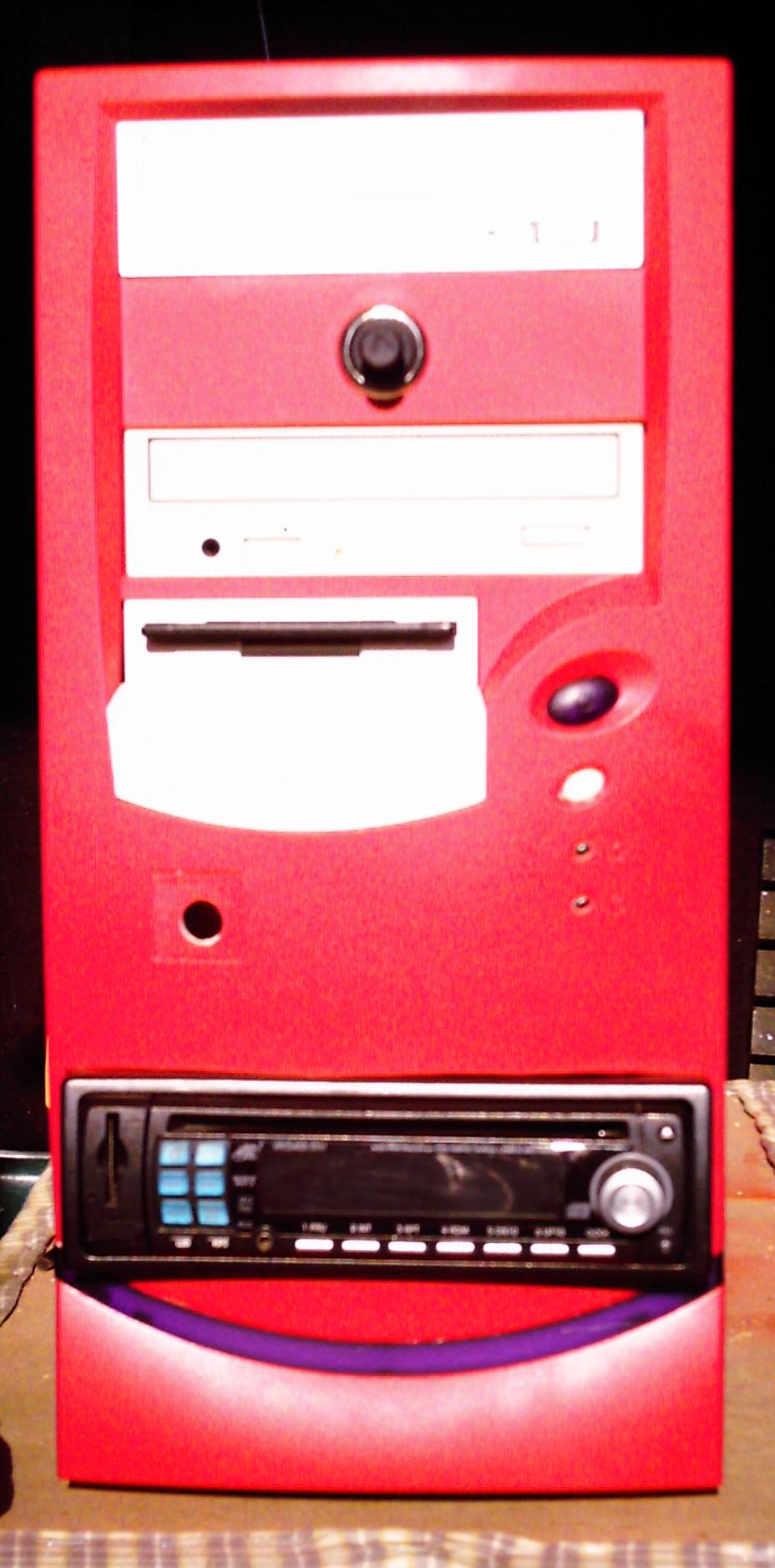

Step 1: Strip Out the Computer Tower
I will not make this on how to build a computer loads of instructions on the web for that .That said eather start with a new tower or strip everything out of an old one .
This tower is a lenov ADM that was used in my lighter mod .
The tower must be complety striped as chips from the sawing /grinding will flat mess up electronics .
I located on the plastic faceplate where I wanted the stereo mounted marked it with a sharpie the stereo has a thin sleeve for mounting it into the dash I slid this off and used it to trace the outline of the stereo mounting hole.
Drill a 3/8" hole into the 4 corners of faceplate then connect the holes with a saw ( jig or sawsaw) light work with a file made the sleeve fit the faceplate nicely.
I then mounted the faceplate to the tower,dropped in the sleeve and traced the cut I needed on the face of the tower.The side the MoBo mounts to was in the way of the stereo so it was rough cut to make room.

I side mounted my pair of USB ports as it was much easyer than making a front mount for this computer.
The Lighter stayed .
The hole in the faceplate is for another mod" how to light up your case badge "
I put a fan in each side of this tower , and it has an exaust fan as well.
Painted the face and top blood gulch red .
the stereo is powered from a seperat power supply.
the front speakers go to a kicker box under my table the tower lives on.
back speakers are jacked to the input of my sound card .
the stereos remote has front rear fade so do not need the computer on to listen.
I did not hook up the in side of stereo to the output of the sound card maybe later .
