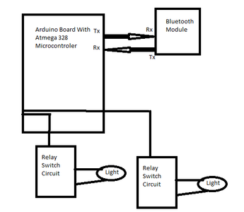

8. some wire to connect arduino with Bluetooth,uln2003ic

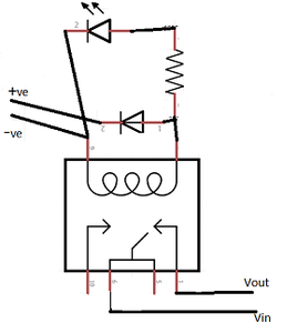

Step 1: Step 1: Making of Digitally Controlled Relay Switch
This is digitally controlled relay switch . This switch is connect with uln2003 lc that is connect with arduino

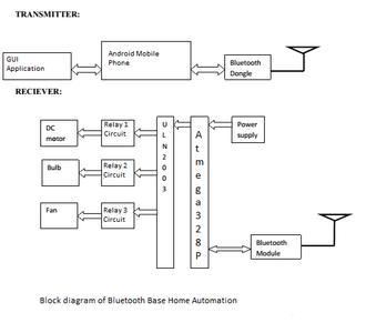

Step 2: Step 2: ULN 2003 Ic Circuit
This is simple circuit because of uln2003 ic. Because Micro-controller controller does not give
enough power to control Digital Control switch to get enough power we use ULN 2003 Ic to increase the power.

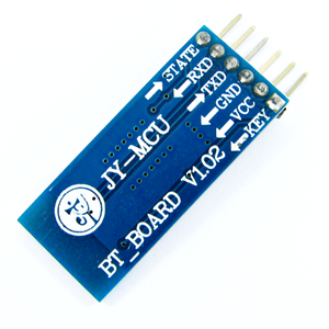

Step 3: Step 3: Bluetooth
I use this CZ-HC-05 bluetooh.This bluetooth module received command string from android mobile application serial and give command to micro-controller .
Step 4: Step 4 : How Relay Switch Connect With Normal Switch
This circuit diagram show you how u connect.
