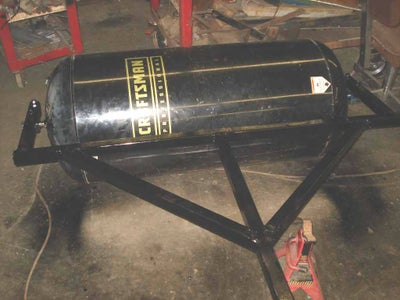

I made this lawn roller from a old air compressor i have had for many years. The 60 gallon tank is the perfect size for the project.

Step 3: Drilling Pin Holes
Step (1) find center on the top of the compressor and drill a 3/4 inch hole
Step (2) the drain plug on the bottom is already on center i just had to drill the 3/4 inch hole.
Step 4: Making the Roller Pins.
Step (1) i bought two 1 inch implement pins and two 3/4 inch stop collars from tractor supply for 15 dollars.
step (2) i had to turn the threaded side down to 3/4 of a inch on both pins to fit into the holes in the roller ,Then i had to turn the other 2 sides down to 3/4 of a inch to fit into the pillow bearings.
Step 5: Welding the Pins.
Step (1) i then welded both pins into place on each end of the roller.
Step 6: Side Frame Tubing and Mounting the Pillow Block Bearings
step(1) the whole frame was made from 1 1/2 x 1 1/2 squared tubing. 1/4 inch thick.
step(2) i cut 2 pieces 22 inches long .
step(3) marked holes for pillow block bearings and drilled holes and fastened them together with 3/8 x 2 1/2 inch long bolts.
Step 7: Making the Cross Beam
step(1) measured and cut a piece 70 inches long and welded it to the pillow block arms.
Step 8: Toungue Assembly
Step(1) i cut a piece 3 foot long to use for the tongue.
step(2) i measured 35 inches down the front main support and marked it.
step (3) i then welded the tongue to the mark on the center of the main support .
step(4) I then measured up the tongue 20 inches and put a mark. then measured in on both sides of the main support bracket 6 inches.
step (5) i cut 2 support braces 27 inches long and welded them to the marks.
Step 9: Finishing Touches
Step (1) 2 cans of gloss black paint. and then mounted a 1 7/8 receiver end and its finished. All thats left is to fill it with play sand .
