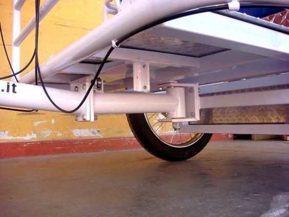

the idea now was to mount the front wheels directly to the frame (see detail). looking at pics of original christiania bikes i saw that they put the wheel axis not in the middle but a bit more to the front of the frame. also i wanted to have a handlebar that can be adjusted in height, thus only two short steel tubes were welded to the back of the frame where i wanted to put the handlebar in.
EDIT: the wheel axis at christiania bikes is moved a bit to the front but still behind the pivot. mine was in front of the pivot... i changed it after riding the bike for a few months and now steering is much easier :-)

the measurements in this pic are the actual ones of my bike. if i would build one like this again i would change some things:
1) don't make the handle bar straight. it should be bent like in the drawing. this will save some space and allows to sit more straight.
2) use 20'' wheels for the front. this lowers the center of gravity and improves the handling on sloping grounds. the problem that arises is that you can't use the simple pivot i used - there's not enough room left between the ground and the box. a solution would be to
3) use conical roller bearings (these are parts used in cars) instead of the pivot .
4) don't build that double-break-thing for the front wheels yourself. you can purchase a better thing known as "double barrel brake lever" quite cheap which allows for independent adjustment of the two brakes.
5) adopt the size of the box to your needs. for me it's fine - i need to transport two kids and stuff at the same time (some times there are 4 kids and their things in the box...). if you don't need that much space make it smaller! because even the slightest wind is a burden if you have to pedal against it... one way to go would be to build a box from cardboard and to refine it until you think it's good. then build it from wood.
6) a camber of wheels improves the handling even more.

Slowly but surely working on my first one. I am using 20 inch wheels that I found at some garage sales.
I am realizing that I am going to have to use tapered (conical) bearings rather than the steering fork due to the lower ground clearance. I understand that Christiania uses tapered bearings as well.
There are not a lot of instructions online how to set up a shaft and tapered bearings for a cargo bike, but there is one here at 2:20-3:44 that might be useful for some.
http://www.youtube.com/watch?v=XSOTP1xj36Y
carkat, is this the way you envisioned the conical bearings working?
As always, thanks!!
Reply 8 years ago
hello, i also have 20'' wheels, but i seem to have enough clearance under the pivot (even if it came from a tall bike, my wife's bike pivot is 3,5cm shorter), 4cm, without tyres
Reply 10 years ago on Introduction
hi,
yeah, this would be the pro-approach. i was thinking of using bearings including pre-made housings and somehow attaching them to the frame so there's no lathe needed. examples are here , here and here (e.g. hub II).
another approach would be to adjust the clearance so you can use the bicycle head tube like this guy did here
