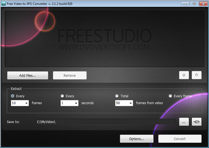

Step 2: Download and Install Software( Free Video to JPG Converter )
in order to get the best picture out of your video you should use the proper software to get all the video frames as images i used Free Video to JPG Converter
Step 3: Use the Program
1. add the file(video)
2.select ''Every Frame"
3.convert
Step 4: Find Your Image
once the converting process has finished you should find the best photo
this can be done by the following way
1.first watch the video ,see and note the exact second of the video when the lightning appears
2.then if you know the fps of the video you can calculate the photo's "serial" number as shown bellow
number=seconds*fps
3.search for the photo it should probably not be so difficult to find
