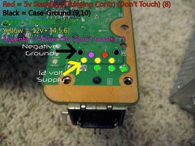

Step 4: Solder Your Leads In
flip the motherboard over and under the power input you should see a series of solder points, this is industrial, lead free solder which has a very high melting point, so its best to use an electric solder gun.
the picture below is not mine, all credit here goes to QuackMasterDan, whom i based a lot of my project on.
so take a good length of thin red wire, and solder it to the yellow pin indicated by the yellow arrow, and a thin black wire to the black labled pin indicated with the black arrow, the pins have enough solder on them that you will not need to add solder to them
next insulation is needed, so simply hot glue over the leads you soldered in, and run them to the near edge of the motherboard, where the fans normally sit.
that is all that is needed, so simply reassemble the unit, making sure to run your two soldered wires into the space of the console where they can be accessed without having to remove the motherboard again.
