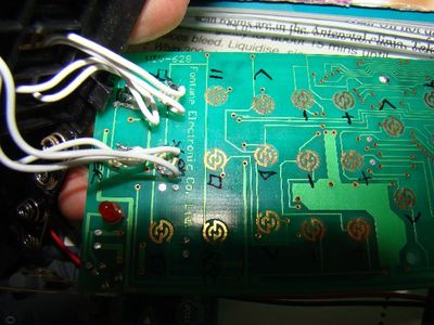

Step 2: Modifing the Old Remote Control
to start with I carefully prized open the remote control.
So I could get to the button contact on the PCB.
I soldered some fine wires to each side of the button contacts that I was going to use.
and I cut away the rubber buttons so I could feed the wires out of the holes.
Then I just clipped the remote back together.
and tested it by touching the wires together to make sure it made contact and still worked corectly.

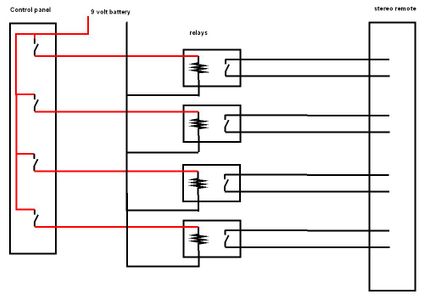

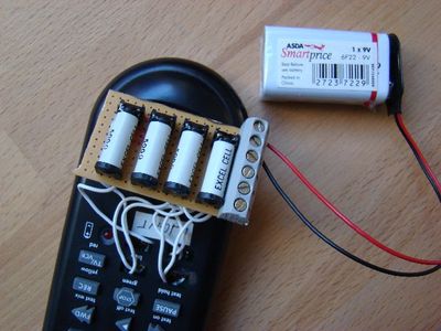

Step 3: Making the Relay Control Board
I only needed to control 4 buttons. so I got hold of 4 read relays.
just add extra buttons and relays as required.
and wired them up as shown in the circuit diagram.
I soldered the relays to a piece of vero board and then fitted a terminal block so the control panel can be connected.

Step 5: Testing
then It was just a matter of wiring the switches to the relays and attaching the 9v battery.
when I press each of the buttons they activated each of the relays which will activated the remote control.
and send the signal to my stereo.
