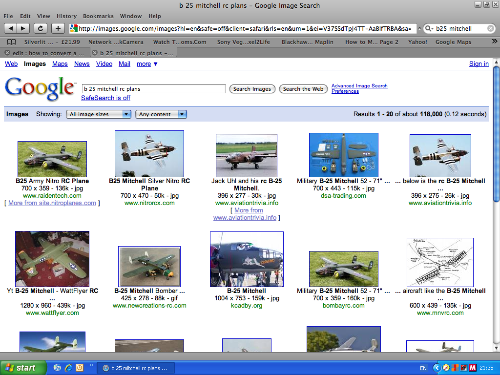

In the introduction, I mentioned that the plane you want to emulate could be anything within reason.Now, don't do what i did the first time i tried this and build a big and ambitious scale 747 or something similar because unless you really know what you are doing,it simply won't work.If you are doing this the first time I would recommend trying a simple,two engined propeller plane design.One VERY important thing to remember is that this will be nothing like the plane you are modeling it on.Sure,it may look like a Avro Lancaster etc,but if your building it this way it won't have the same shape at all.Do a google image search for "plans" of your plane,and if you cant find any there look on the profiles of the plane on sites such as wikipedia as they sometimes have ready produced profiles of them. if you still cant find any try http://membres.lycos.fr/wings2/3vues/3vues.html.It's in french,but if you are not fluid in the language (I really was not when I wrote this) translate it with google's translator.

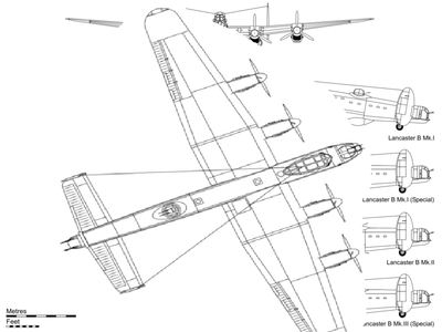

After youve found your plane you could just print it as it is,but i usually use ms paint to enlarge it to the actual size of my aircraft.There is no fixed size for the aircraft,but a little bit bigger than the size of the original xtwin is a sensible size for the engines to handle.In your plans you MUST at least have a front and side view of around the same length.
