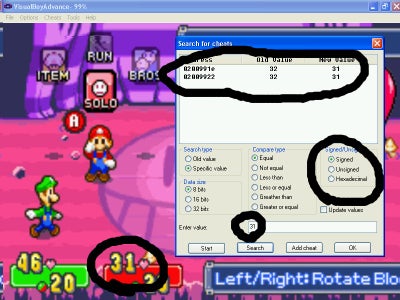

note this assumes that the emulator you are using has a address searcher on it, if it doesent I think you can use a external one(like artmoney or cheat engine)
i recommend that you use "vba"(virtual boy advance(a gba emulator(i can't tell you were to get it). it has a searcher built in to it. the pics are me hacking mario & luigi super star saga rom(again can't tell you were to get it)
first find the amount of the thing your hacking.
as in if you have 100 hp then you search for 100. i have 32 hp so i searched for 32
so do that.
the change the amount as in lose some health. i lost 1 hp.
then search for the new amount. keep doing that until you have like 6 addresses left. then change all the addresses and the amount should change and that gives you the front of the code. the back is just 00000000 with the amount at the end. i had 31 hp left so i searched for 31 and had 2 address left. then i changed the address and that gave me 100 life.
