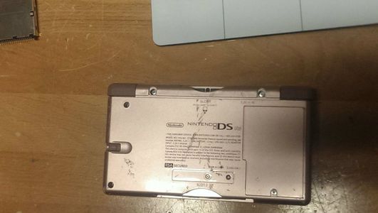

Step 2: REMOVING THE BOTTOM PART OF THE CASE
  1. the first thing you need to do is get a Phillips screwdriver to remove the battery cover
  2. after removing the battery cover remove the battery by inserting a pry tool in the slot shown in the picture to gain access to all the screws
  3. now remove the 4 trywing screws and the 3 phillips screws
  4. if you dont have a magnetic mat find a way of keeping track of your screws so they dont roll of the bench or get lost
  5. the area closest to the hinge can be pulled open with just your fingers as shown in the picture
  6. the area away from the hinge is a little harder to just pull open but if you have a pry tool just slide it around the case as shown and it should open up.

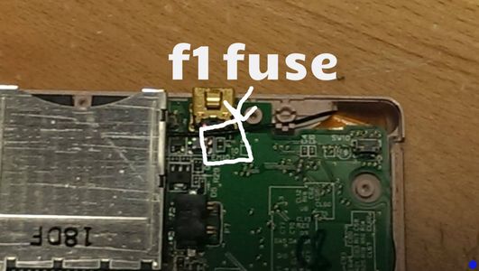

Step 3: FIXING THE F1 FUSE
  1. first you need to find the fuse its right under the charging port check picture for reference
  2. now that you have located the fuse you want to check it with your meter by setting your meter to ohms to test this touch your 2 test leads together and you should here a beap
  3. now touch your leads to each side of the fuse if you hear a beep your fuse is good but if you get nothing your fuse is blown and is most likely causing your system not to turn on
  4. to fix the fuse were goin to start by adding flux paste to both sides of the fuse
  5. now take a thin piece of wire and strip a little off the end and place to cover both sides of the fuse
  6. now solder the wire to both sides of the fuse to create a jumper across
  7. these parts can be hard to solder make sure you have good contact on both sides of the fuse you can see in picture 8 i only have one side of the fuse soldered
  8. now that your done soldering you have some left over wire take your flush cutters and cut the wire as close to the fuse as you can so you do not have wire hanging around that could short something out
  9. now all you have to do is clean the area up and clean up all the flux paste from the board add some rubbing alcohol and wipe with a rag or q tip
