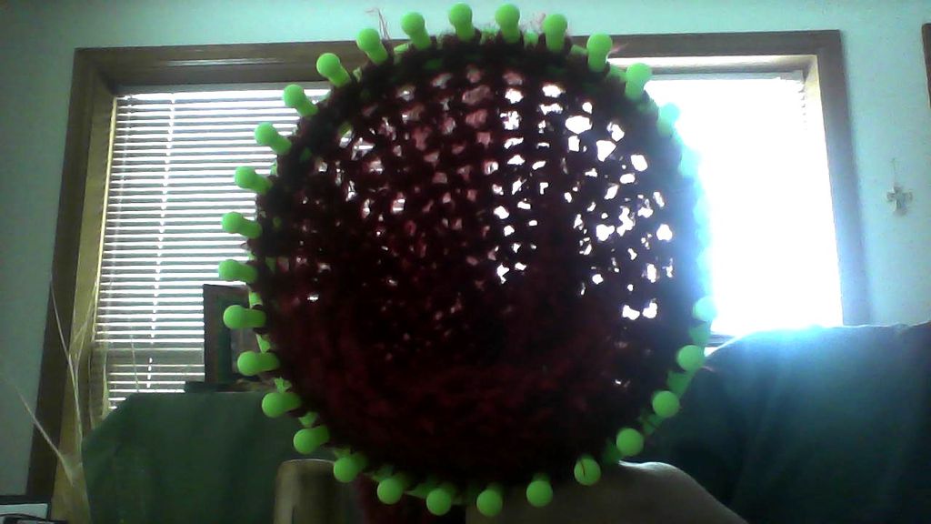

Step 10: Loop the End of the Scarf Back Over the Pegs
Much like the brim of the knitted hat I did, we're going to bringing the very beginning of our knitting back over the pegs.
Pull the beginning of the scarf through the hoop as shown above. Make sure it doesn't get twisted!
Now you'll want to bring the loops at the very beginning of the scarf over the pegs. It might take a couple tries to get a loop on each peg - they can be tricksy!
Keep in mind that one of the loops is a little hidden on the end next to the yarn tail from the slipknot. You might need to use the loom hook to get that one. (see picture three to see which loop I mean)
