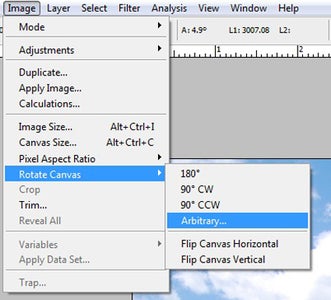

After that go to Image > Rotate Canvas > Arbitrary.

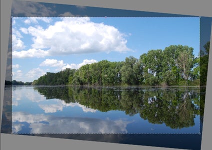

Take the Crop Tool and crop the image like you see below.

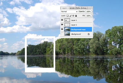

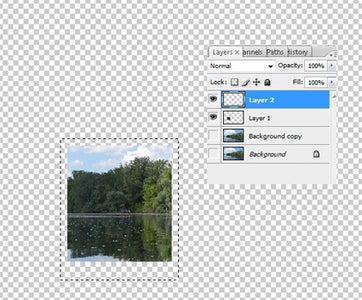

Take the Rectangular Marquee Tool and make a small selection anywhere in the image. You can move your selection by holding down the Space key. Copy and paste the selection. Make a new layer using the New Layer Icon in the Layer Palette. Turn the other layers invisible and take the Rectangular Marquee Tool again. Make a selection around the first one and keep in mind that you’ll going to make it look like a Polaroid photo, so make the selection look as the border of the Polaroid.

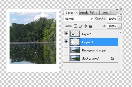

Press D key to reset the foreground and background color to black and white. Now press Ctrl + Backspace to fill the selection with white. Deselect (Ctrl + D). Drag this layer under Layer 1.
Step 10:
Let’s merge these last two layers together. Select Layer 1, hold down Ctrl key and click on the Layer 2 (but not on its thumbnail – this will tell Photoshop to load layer’s selection and you do not want this now). Now press Ctrl + E. You can rename the layer: double-click where it says Layer 1.

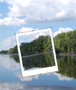

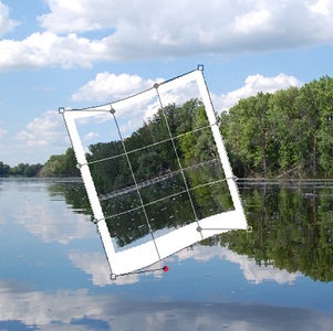

Now you can use Free Transform to rotate the layer. If you want you can use the Warp Option to make the image a little curled.

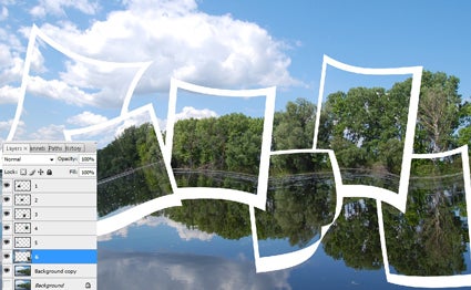

Step 13:

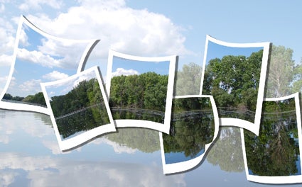

Keep doing the last two steps until you have the result you want.

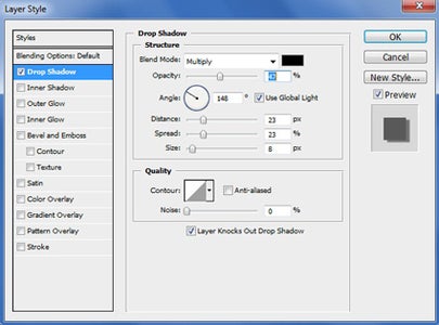

Let’s apply a Blending Option. Double-click on one layer and go to Drop Shadow. Apply the next settings: Blend Mode: Multiply, Opacity: 47 %, Angle 148, Distance: 23 pixels, Spread: 23 pixels, Size: 8 pixels.

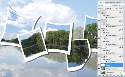

Right-click on the same layer and copy its layer style. Select the other layers, but not the Background layer and paste the layer style.
Step 5
Make a new layer above the Background layer and fill it with white. Reduce it’s opacity to 45%. This will make you Polaroid effect stand out. And you’re done!
