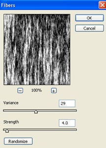

Step 4: Time for the SEA!!!1
to make the sea you will first need to make a new layer and fill it with your background colour
then go to filter> render> fibers
and click randomise a few times until you get something like this
Step 5: Roatation
click Edit> Free Transform right clikc on your selection and choose roatate 90 cw
then move the fibers until yours looks something like this
