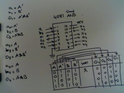

for A=0 and B=0 --> O1=1
for A=0 and B=1 --> O2=1
for A=1 and B=0 --> O3=1
for A=1 and B=1 --> O4=1
it explains itself:
not A and not B is O1
not A and B is O2
A and not B is O3
A and B is O4
more garbage here:
A' & B' => O1
A' & B => O2
A & B' => O3
A & B => O4

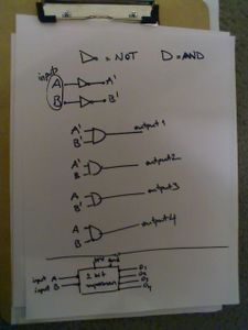

we need to find a way to invert A and B,
so that we make 4 inputs out of 2, A,B,A' and B'
then "AND" them,ie place them serially
here's how:

well,we need two NOT gates. to make A 0 when it is 1 and 1 when it is 0 etc..
we also need 4 AND gates.
we can do this whole thing with transistors.
or we can simply use 2 little chips. (you can do all types of combinational logic,you can use NAND,or NOR gates or you can go with only one type of gate and do everything there,including the NOT gate,but this one is going to be simple,and straight forward)

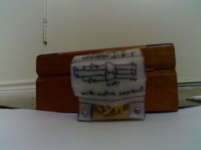

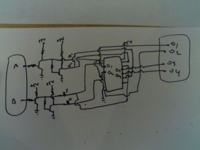

anyway,
after you have your AND and NOT gates, (i recommend using IC chips, like 4081(AND) and 4009(NOT))
they will occupy less space and be more reliable.
mine is a hybrid,
it has 2 transistor NOT gates with 4 transistors and one 4081 AND gate.
after you have your gates ready,all you do is,go back,read the theory of how this thing works,
and wire it up. that's it.
summary is: invert A and B, then combine A,B,A',B' in a way that fits your needs

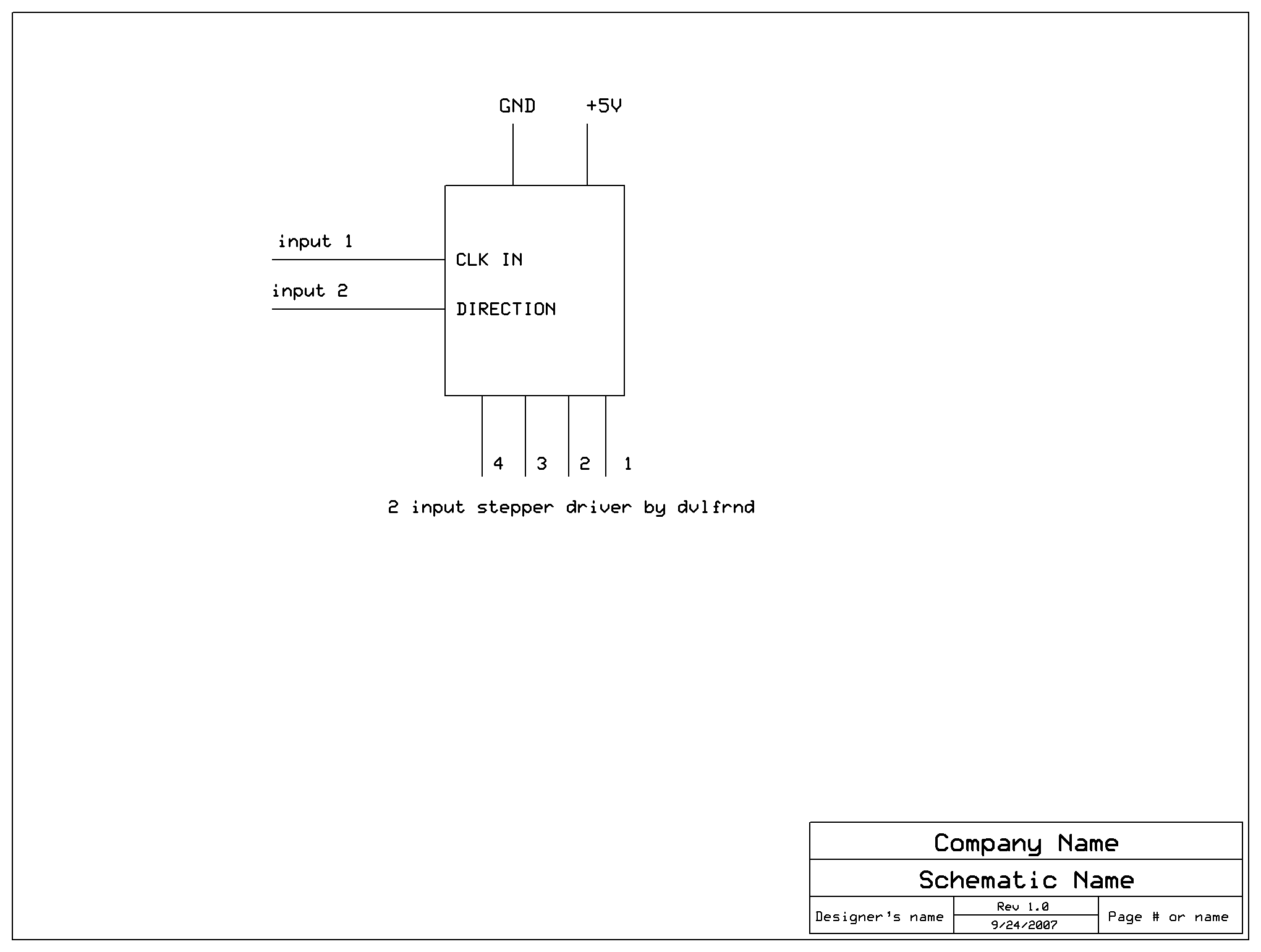

my next instructable will be about my third project, driving a stepper motor with only 2 cables.
one for the pulse,the other for the direction.
you can combine it with the 6 input version of the device explained here and control 64 motors with one parallel port (in theory :))
