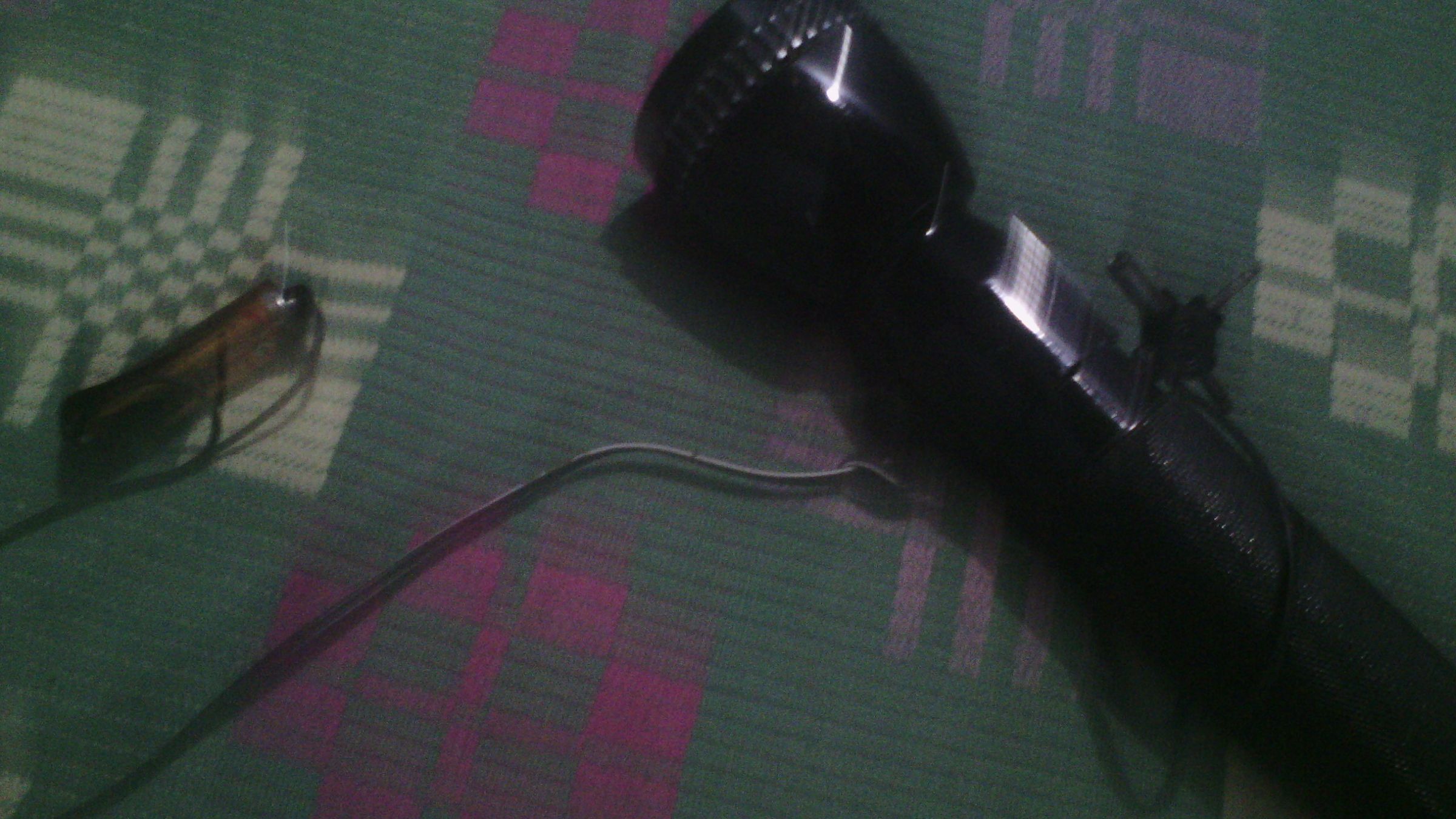

Step 2: Assembling
take your LED's and solder it to the PCB ,also solder a small wire for positive and negative terminal of led
Step 3: Connecting Battery
in this photo you can see the battery at the back of led which is a mobile battery.
now connect the positive terminal of led to the positive terminal of battery(which is a short wire that you had solder to PCB.take a new wire which should be the length from mulguard to break pad of cycle and connect it to the negative terminal of battery .also take another wire which is of same size and connect it to the negative terminal of LED lights .
Step 4: Connecting to Break Pad
after doing it you can get a two free wires . when it is connect each other the LED glow's. stick two wires at two end's of break pad in such a way that both wire touches when we put break handle.
Step 5: Fixing Your LED's With Battery
put the LED' s with battery in a plastic glass to prevent rusting from rain . and tie the plastic glass with flower tape or insulation tape ( you can see two wires coming from the plastic glass). also tie it to the back of carrier.
